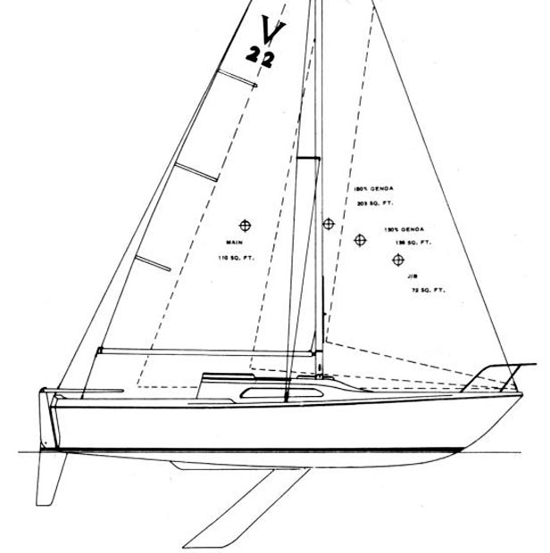

A portager 22 is essentially a Venture 22. Almost identical in design with a different rub rail around it. You should connect the back stay and the side stays. Put the base of the mast in mast step hinge. If there is a slot in the base, then the pin is threaded into that. I assume it is L-shaped so that the mast pin pushes in from aft and then falls down as you raise the mast. That should suffice for sailing. The other hole is not used in mast pivoting. After you walk the mast up like a ladder another person puts the forestay pin in giving the mast a 4-point support. If you find that half way up the mast will not go further, then your side stays are too tight, or your backstay is catching on something, or your turnbuckles or stay adjusters are not pivoting at the chain plates properly (binding). It was the case with a Tanzer 22 that spacers (like a carabiner) was put in between the turnbuckle toggle and the chain plate to give the upper side stays enough extra length to assure that the mast had enough room to swing through that "over center" position half way up. After the mast was up, then you could hook up the inner shrouds and remove the outer shroud spacer. Perhaps this is needed for the Portager 22 as well.
