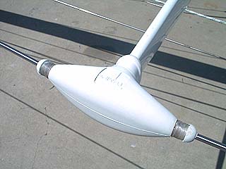

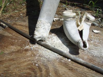

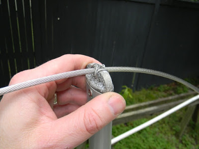

Last night we had a race in 15-20 knots, with VERY lumpy seastate at the starting area and lower 1/2 of the course. Just after their start a Capri 25 lost its mast. No one was hurt. Back at the dock, I asked a crew member what happened. Seems that the small wire that is used to hold the shroud to the spreader tip broke or simply fell off under the rubber boot. While pounding upwind, the shroud jumped out of the small groove at the tip. First the crew noticed the cap fall off, then the shroud was out. A few seconds later, the mast was down.
If you have a boat of this type/generation, I'd really suggest taking a look under that rubber boot and check the state of that little wire. It was an iffy way too hold the shroud on, but is OK if the wire holds. But it if fails you're going to have issues. Newer boats have better spreader tip design to solve this problem.
99% of mast failures are maintenance/inspection issues. They don't just fall down.

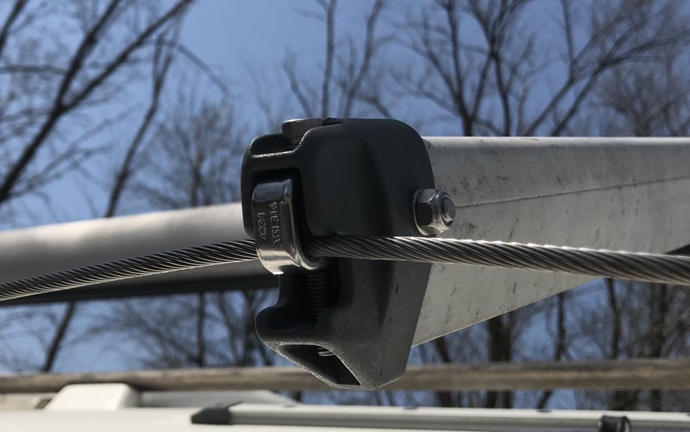

My rigger hates spreader boots, now I know why, he even confiscated my shroud turnbuckle covers! But that bailing wire shroud attachment is just rinky dink, dissimilar metals too. Needs a proper shroud clamp.

yea, there's a reason modern spreader tips look like this. All SS at the contact point. Holds the shroud super securely. Smooth shape with low windage, nothing to snag and does not need a boot.

The mast broke in two at the spreaders, and they punched a nice hole in their laminated mainsail right aft of the boltrope. That should be an easy repair. The WYC Capri fleet actually maintains a stock of C25 masts. They lose 1-2 on average every year. AFAICT no other damage.
