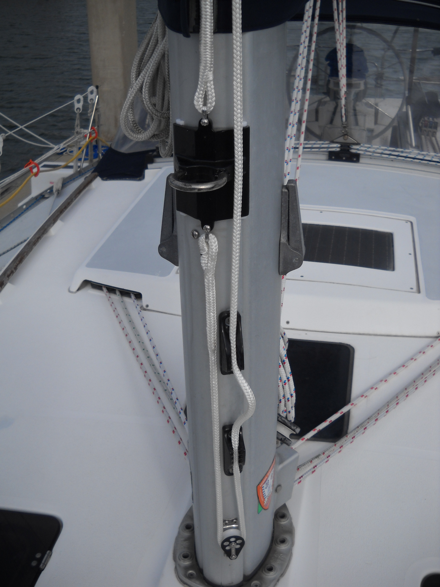

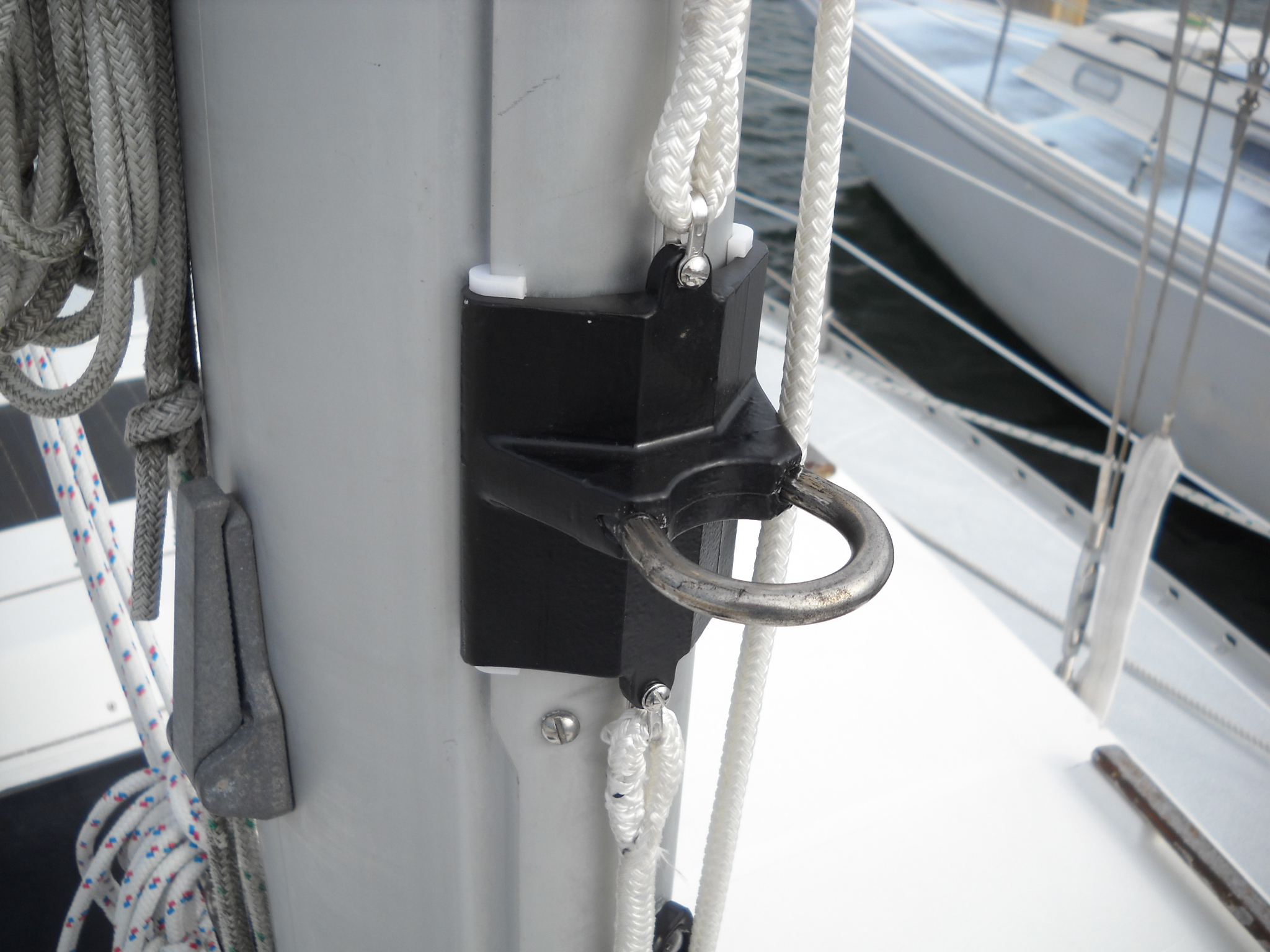

There is a wide track on the front of the mast I assume for a ring to use for spinnaker pole
person I bought from never used a spinnaker and had no info.
Is this a track for a adjustable ring and where would I get one?

Welcome. We would need to know the dimensions and profile of the track to answer your question. Photos are helpful too.
Dec 18, 2012
185
Hunter 37.5 Annapolis
Per Rick D, go to rigrite.com, but it would more likely be Isomat NG-70 section like my 37.5.
8,050
Beneteau 323 Annapolis MD
I'd measure it for track width and thickness of the flange, as it was probably owner-installed, not OEM.
