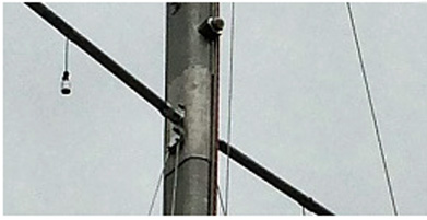

You may try one of the many marine salvage yards, Shipping may be expensive if it's coming from a distance. I was looking at a Catalina 30 last summer that had its mast repaired. The owner had the boat for the last 5 yrs. and this repair was done long before he bought it. Claimed he never had an issue with it. I didn't get a up close look at it, but through a binoculars it appeared to be 1/4" aluminum sleeve screwed to the mast. Apparently the mast broke where the spreaders attach. The boat had way to many other issues that I didn't want to get into.
