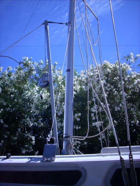

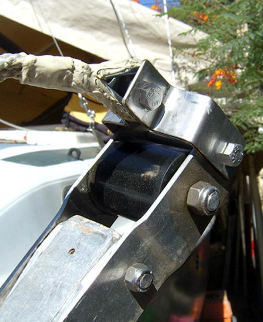

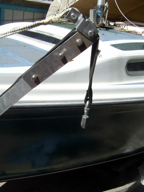

I used a 1-1/2x1-1/2 aluminum pole and made the roller where the strap goes over the end from an old cut down printing press roller (we used to call them washing machine rollers - for us older folks - and you could use a skate board roller also). The winch is a brake winch from Harbor Freight. Bails are flat stainless with a bolt through and a small piece of rubber tube to keep the stainless spread where the flat strap attaches to the mast. There are two lines from the top of the gin pole that attach to the pulpit used as back stays for pole support.

Generally the systems that use a gen pole attached to the forestay and then cranked down with a block an tackle use about a 10' pole. The ones like mine and Bob's use a ~7' pole but are attached to the mast 7' up so it is pulling at a 45* angle. It all has to do with vectors.
