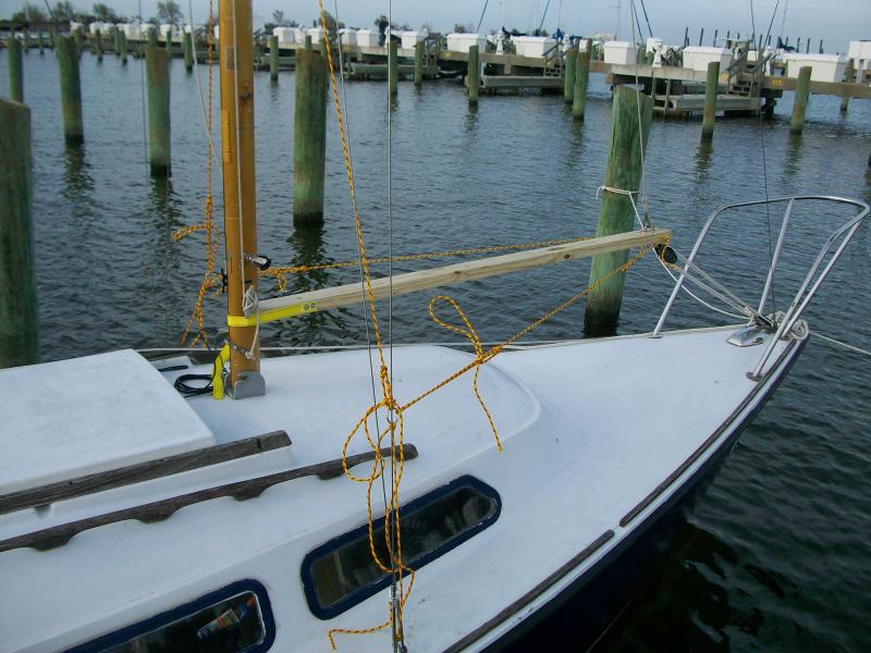

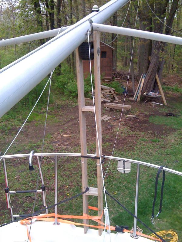

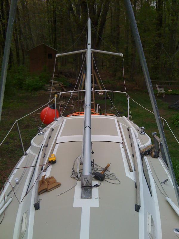

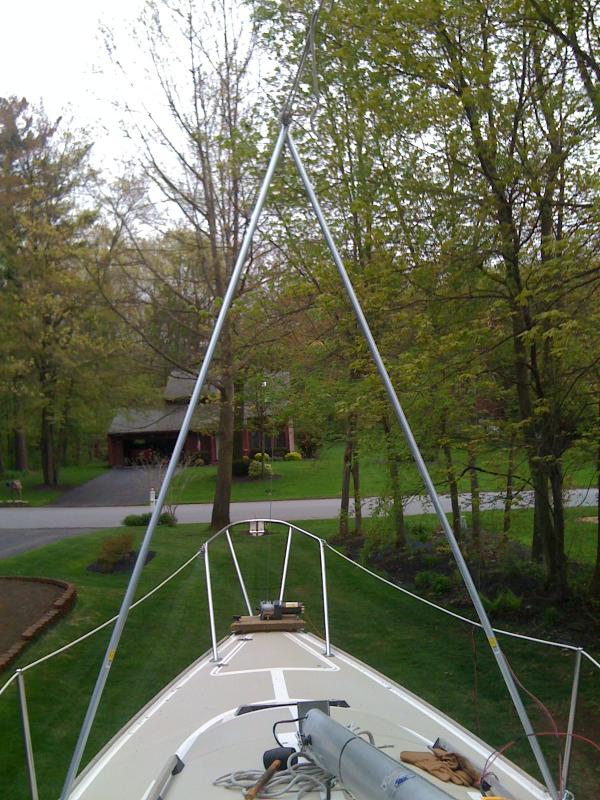

OK, so there it is! Finally put together the mast raising system and like many other projects, what might look perfect on paper, well, may not look perfect in application! Yes it works, and works as expected, but there are a few minor issues I would lie to resolve.

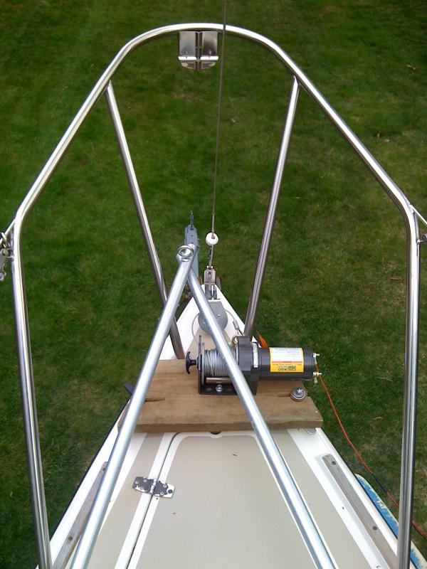

One, I am using the halyard, I am not sure that is the best option and how strong that halyard might be. Am I pushing my luck doing that? I dont have a roller so I cannot use that, just the for-stay cable but want to keep that free to connect I guess.

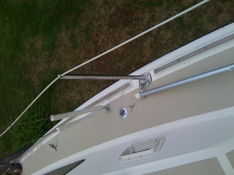

The Second is the A frame. The system I have there binds a little bit at the feet, so I worry if it binds to much will I rip out the stanchion? I think I need a better connector system for the feet of the A frame. More flexibility there but cannot see it at the moment.
I did put a new album up on my profile with images and here are some as well.
Otherwise I am mostly happy with it, I did use solid core wire for the winch as I have rolls of it! So, I might look at that as well. I am not worried about the solid core as this winch system will not stay with the boat, but stored at home. They are just a bit stiff and unwieldy is all.
Any input on tweaks is appreciated.
Happy Sailing.
Happy Sailing.
