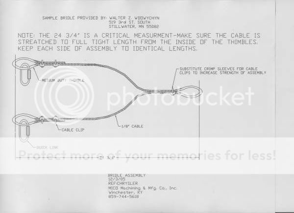

I need the dimensions and material data for making a "mast raising bridle" for a 22' Chrysler sailboat. A picture of one would be great, too! Thanks. M Willis

If you're talking about an "A" frame lifting system....try google... never heard of one specific your your boat.

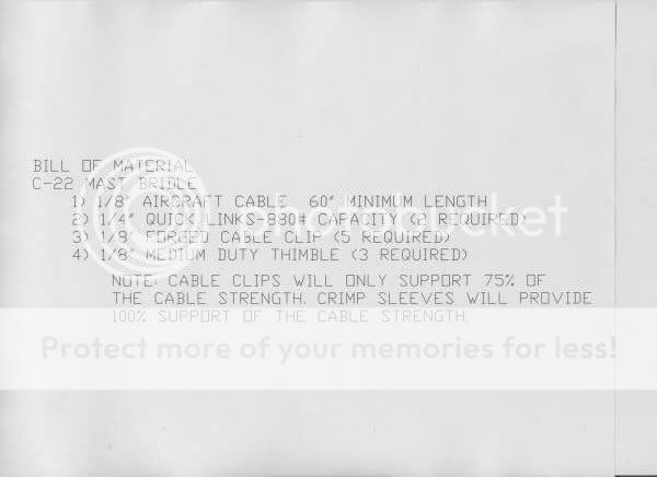

I found a good pic (with materials list and dimensions) of the "mast raising bridle" I was seeking. I'm off to the hardware store now to obtain the materials and make one (actually two). Here is the info for anyone else seeking one, too. Thanks. Longtimesailor
