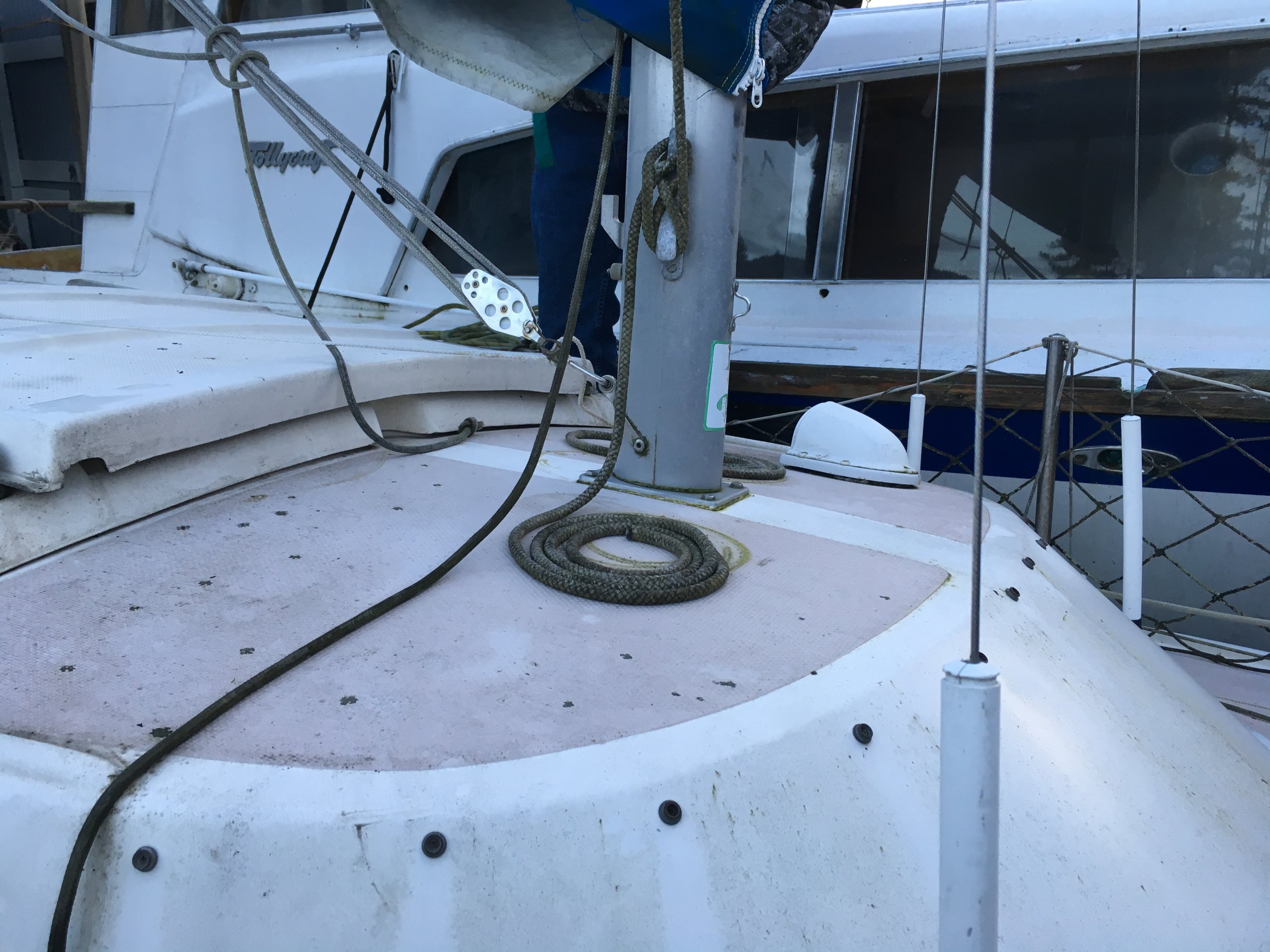

Here is a pic of the current mast attachment. I was hoping there might be an adapter to convert it to a detachable system. If not I can probably design a plate that would work. If you have a pic of the factory setup, that might help me in figuring something out. Thank you for your help

All you have to do is contact www.catalinadirect.com If you call them they will solve your problem right away and you won't have to do any more research....they specialize in this stuff.... installation is fairly easy... because there's just one large bolt through the bottom of the mast that holds it in the bracket. You bolt the mast to the bracket... then raise the mast.. there's plenty of you tube vids on C22 mast raising.
After dropping the mast, you disconnect the single bolt and place the mast in its trailering supports.

Are you sure that is the original mast?
A C22 of that vintage should have a step like the ones pictured. It looks like the mast is installed on a plate (likely with internal socket) that was never an option by Catalina to my knowledge. Also the mast looks more round than the typical profiles I have seen for C22s. I would question the owner about the mast and whether it was replaced at some point with a donor non C22 mast. As others have said it should be an easy modification so long as the glass is good on the step and you can remount the original style bracket before drilling the hole in the mast for the pivot bolt. If you haven’t seen this already the association has a great resource out there on these boats. Seeing these mods if I wanted a trailer sailor C22 I would be a bit leery if the price is not fantastic.

I'm in Canada, I will get some more pics to help. One thing I noticed is that in the cabin there is no mast support. The deck is all that bears the whole weight of the mast. In the few C22'S I've seen there is a wood spindle under the mast area to help support the weight.

All Catalina 22s need a compression post under the mast regardless of year or make. Some are steel, wood, etc... based on the model but since the mast is deck stepped they must have support. The Capri 22 sport has a split support as opposed to a single post but none the less it still has support. If the boat is missing the post and has not been completely customised and reconfigured in some way it's a major red flag and may be cause to walk away from the deal. Nothing worse than trying to unfrainkenstine a boat from a PO as the $$ adds up quickly.

You may find that it a "socket" type mast step... definitely have not come across this in my wanderings.
