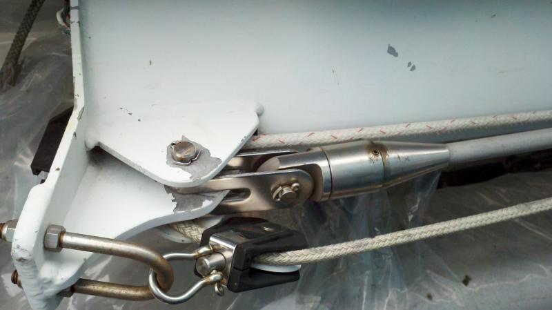

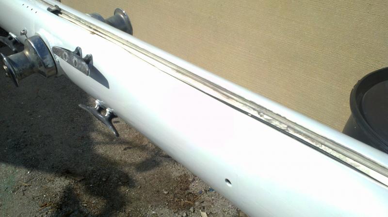

Wow, that's a project unto itself Rick. I could tell you all their names but nothing about the sizes. Bottom up you have: five exit plates for halyards, two winches, the double tangs for the lower shrouds(both sides), spreader brackets and spreaders, two tangs for running backstays, a welded forward tang for the staysail stay, a forward exit with sheave for staysail halyard, heavy tangs for upper shrouds, then the masthead with four sheaves and heavy pins for forestay and backstay terminals. And the guys will help with what I have forgotten. You could save a lot by making it a sloop rig. A lot of these parts are in my pictures: http://hunter.sailboatowners.com/in...&cat_id=38&aid=7938&page=article&mn=37-cutter .
P.S. forgot the cleats. I have three on one, two on the other side plus they had a cam cleat for the jib halyard(although I noticed Bill D had rerigged with his main halyard on port and using that cam cleat).
