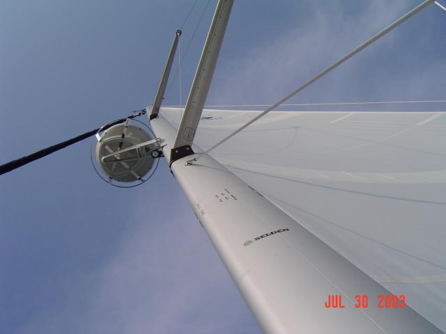

Get a radar guard
I have never had a problem with the headsail and my radar but I have a radar guard that allows the sail to slip right aroung the mast mount.
