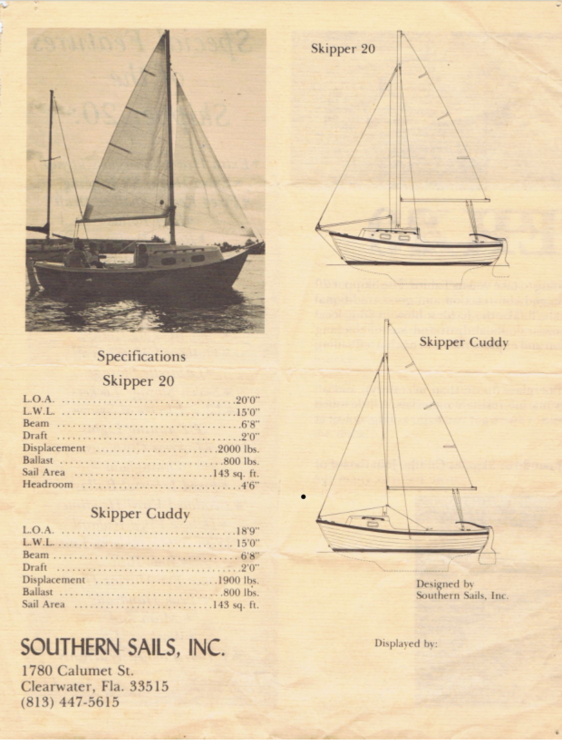

A little history I found on the manufacturer.

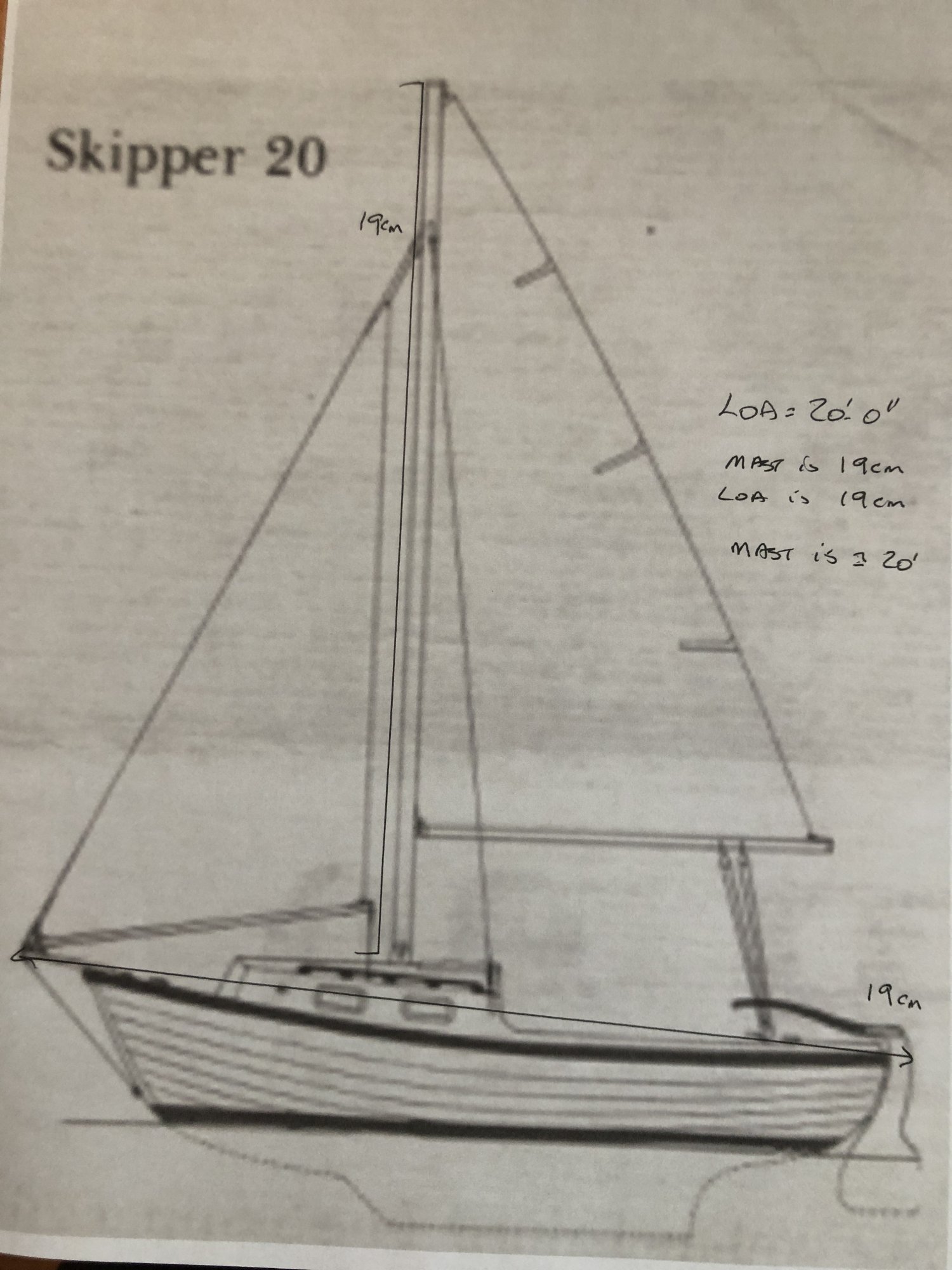

Based on the assumption that the attached drawing is scale you could calculate the mast length by using the LOA dimension of the boat. Not sure how accurate you need this to be.
