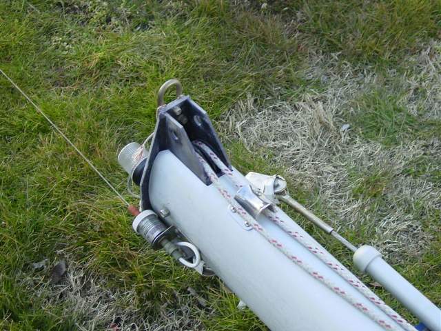

does anyone have a photo of the masthead fitting on a Catalina 310.
I would like to fit a code zero and find that the spinnaker bail does not extend far enough forward to clear the headsail furler. The code zero will fly from a facnor furler as well .bottom end attached to anchor roller extension,which has been beefed up with a bobstay.
I would like to manufacture a fitting that can be attached to the top of the mast while it is still standing in the boat.
I have fitted a hoyt jib boom which works a treat and is great in winds over 10 knots but need to get the boat mobile with a bit more sail area in very light winds.
Even with the normal no1 headsail i find the boat sluggish in light airs, and always resort to the motor .

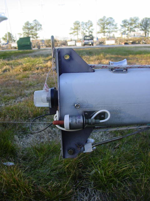

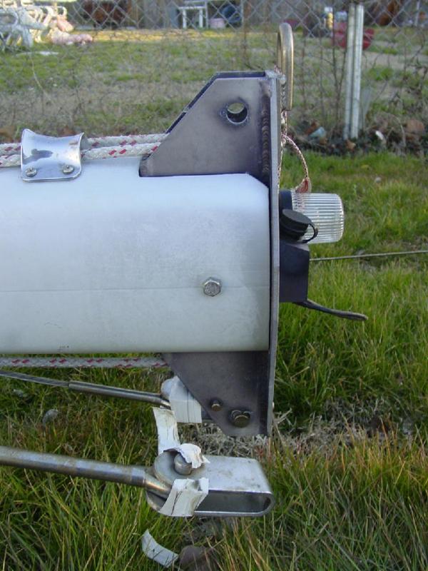

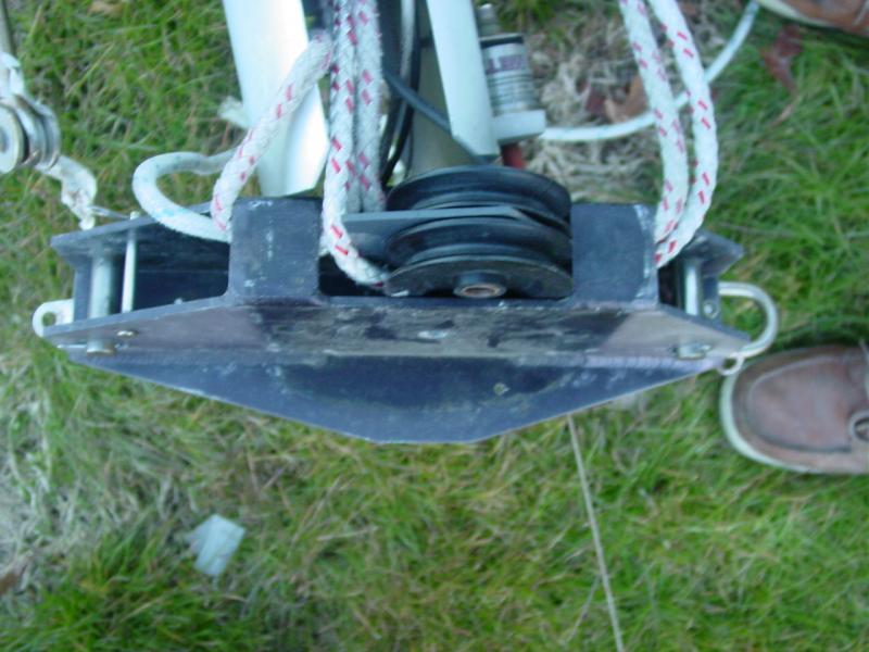

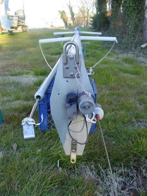

PaulJ did something similar
Check the archives here. He posted pictures of his nephew up there adding the fitting on the masthead.

Thankyou for your comments. Looks like Paul J came up with the goods again,Thank you Paul J. Looks like you could unscrew 4 screws from the spinnaker bale and make a new fitting using those same holes.
