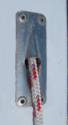

One of my winter projects is to install 4 additional exit plates to supplement the 2 exit plates that were originally installed. I'll have a total of 6 exit plates to serve internal halyards for 4 masthead sheaves, 1 spinnaker block and 1 spinnaker topping lift. The mast section is Kenyon MORC 4060.
My question is how to space the exit plates so as not to cause any structural failure of the mast. The only reference that I can find is from Selden. Their instructions say that on each side of the mast, exit plates must have 12" (30 cm) vertical separation. I'm assuming that I can offset the alignment slightly, rather than placing them in a vertical line (3 on each side). They seem to indicate that you can pair the exit plates on both sides of the mast, meaning that it is ok to have a hole at the same location on each side. I suppose this sounds like a reasonable guideline. The only reference I can find for Kenyon masts is thru Rig-Rite, Inc. Aside from getting any guidance here, I will resort to their recommendations over the phone, assuming that they will be helpful.

12 inch vert separation is good. 6 inch stagger port/starboard. Horizontal alignment over the deck turning blocks. Avoid any exits in line with the boom. Halyard exits (in particular spin) as high as possible to facilitate jumping.

Thanks, that sounds right with regard to staggering the port/stbd sides. I know that the existing openings are staggered, but until I measure, I don't know the distance for sure. I'll have to base my pattern off the original 2 openings.

If @Scott T-Bird already bought the parts it may be too late for my .02, but... Since I'm switching to internal halyards also, and with a smaller boat I have a smaller spar with thinner wall, mast exit boxes w/sheaves scare the crap out of me. I have seen masts on 30ft boats fold where the big square cut was made for the box. I like Ronstan exit plates; inexpensive, easy to install, only one fastener, smooth fairlead, and easy to remove if you get corrosion between the dissimilar metals... but most notable is that cut requirement is a very narrow slot (two holes and a dremel metal cut wheel, clean up with a fine file). The smallest size takes up to a 3/8" halyard, the medium up to 1/2 inch.
Echoing posts above, don't compromise spar strength by staggering exit cuts horizontally and vertically.

No, not the usual (with the Ronstan exit plates) and that's my point... There are no corners, you make a narrow oval slot for the halyard to pass through. Let me clarify that the Rostan exit plates are only for the line entering the mast at the bottom, there is no turning block for exiting the mast at the top in the case of the Spin halyard. In those cases I like the Harken thru deck blocks. The medium size can take a 5/16 line without rubbing and the cut slot is significantly smaller than most other blocks. I'll have to snap a pic at home because I cant remember the model number on that one, but it does have a cover plate.
