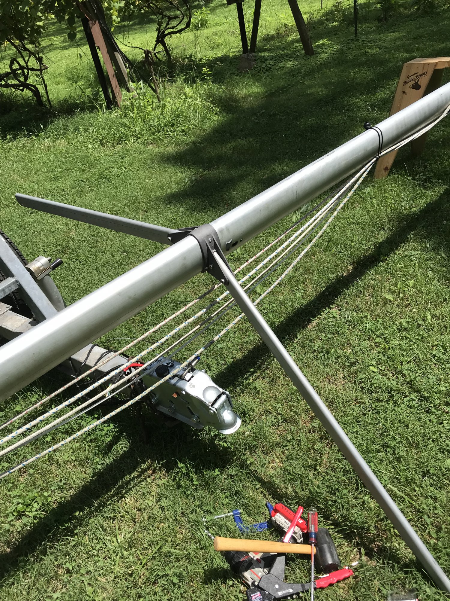

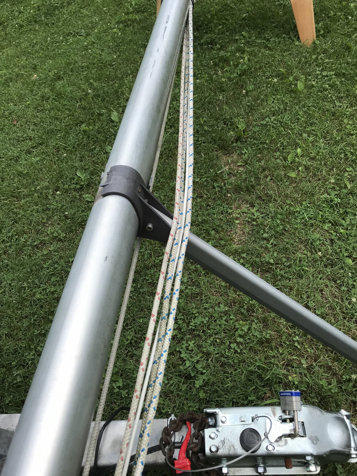

I had to replace the bracket on mine... (see pics) I had a dismasting and broke my spreader bracket. Unfortunately I did not take pics of the process... but
Once the spreader is on the bracket, you can place the open side of the bracket on the mast and then using the spreaders as leavers, pry the bracket open a “smidge” while pressing down and the bracket will slide over the mast. If I am remembering correctly, I had my son gently rap the top of the bracket with a rubber mallet while I pried the bracket open to slip the bracket over the hump of the mast.
