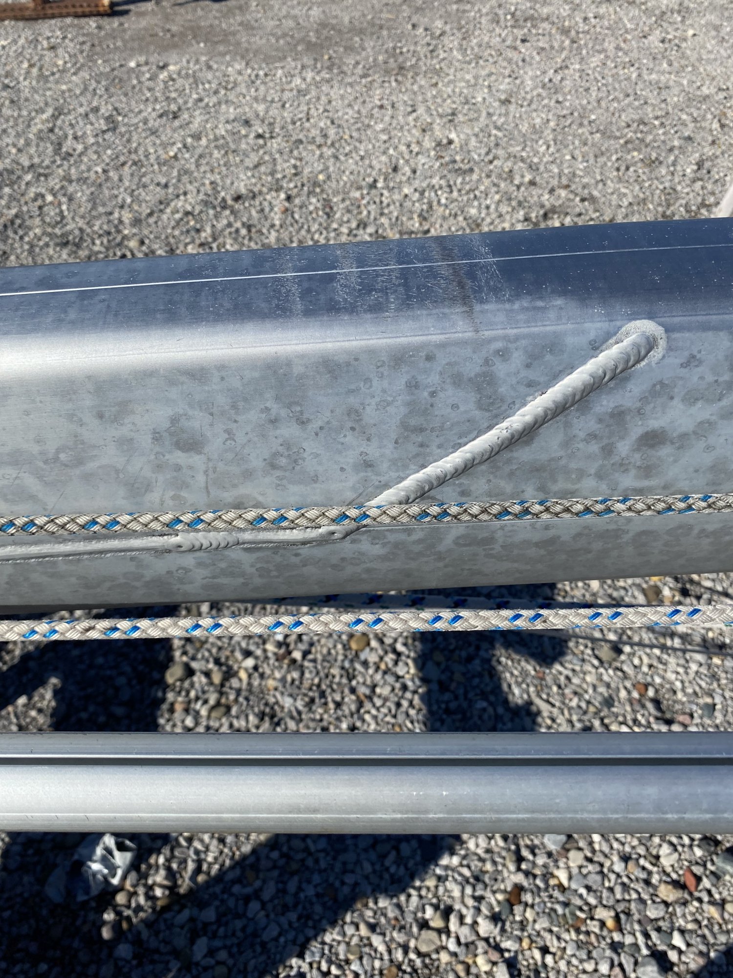

There is a weld on the mast that I don’t see on other masts… does that indicated she hit a bridge at some point? If so, the repair looks good, so I’m not too worried. I do sometimes wonder if I bought the right boat.

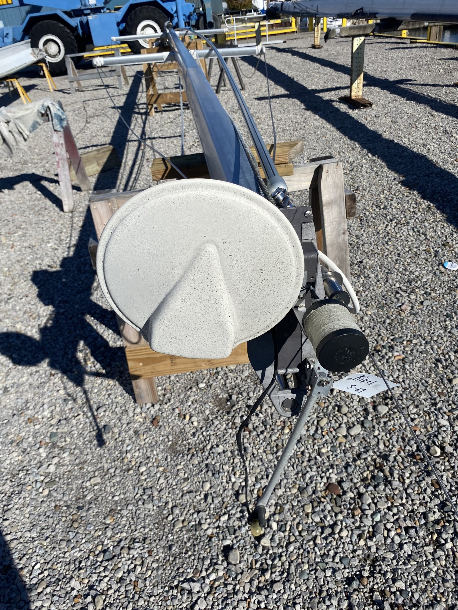

Also, I’ve been wondering all summer what this round thing is. I was hoping there would be a label or something that would give me a clue. Looks like I should be able to get HBO on it.
That is unusual. It does look like a good weld. Ask your rigger.
It is a TV antenna for the broadcast bands. It looks old, probably doesn't pick up the new HD signals.

And, yes about the weld on the tapered upper portion of the spar. That's done one many/most better boats. Good Sign.

You have a UFO-III TV antenna that will receive and amplify both VHF (analog) and UHF (analog & digital) band. It is not the latest and greatest, but unless it has somehow failed, it will do a good job for current TV signals. Your model has 20db of gain, and the latest has 30db of gain. That is roughly 8x more gain.
These units are very reliable- I replaced mine when I had my mast down because I was not getting good reception. It turned out that I just had a failed coax connection to the antenna. But since I had already purchased an upgraded antenna with more gain, I went ahead and installed the new one.
Attached is the instruction manual for your unit.

That weld is common on Catalinas with double spreader rig, I think. It's on my boat. The double spreader allows less weight aloft. You should have noticed the taper. It's a performance enhancer. By contrast, look at a Catalina 34 with single spreader. The mast, at virtually the same height and close to the same sail area is seriously thicker and heavier. Look at a Catalina 36 to see how massive the mast can be and there is no taper at the top. Then look at every Catalina with double spreader and you will see a mast that is lighter weight and tapered at the top, well above the second spreader. I wouldn't worry about it unless the rigger finds a crack in the weld.
That round thing looks like a cover over the windex to keep birds off. But, as others have said, it's probably an antennae.

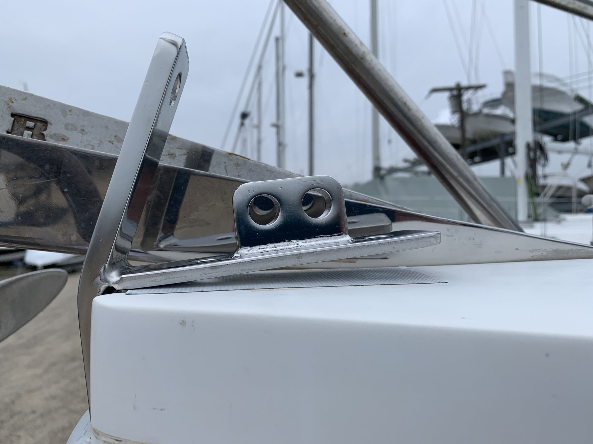

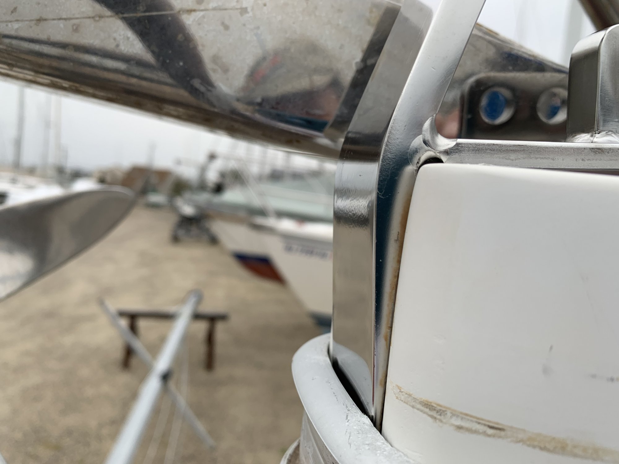

Also, take a close look at the stem fitting. The older ones, like mine, had a weak weld on the flange. There is an article in the Catalina 320 Owners forum that describes the potential defect. Catalina Direct sells a replacement that is far more robust and it was a very reasonable price in my opinion. I have all the confidence in the new stainless steel stem now that it is installed. The original one was sketchy adn I was glad that I read that article and addressed the situation in my first winter with the boat. I replaced all the bolts and was able to get them secured alone, but it would be a much easier job with 2 persons.
Removing it is tricky. You have to take the rub rail and the rub rail frame off where it bends around the bow (that means the rub rail will probably be taken completely off - but the aluminum frame comes off in sections). When I removed mine, the stem fitting needed to be bent ever-so-slightly to get it off when I didn't remove the rub rail frame. It made a difference because the new one will be custom-fit. You send the old one to CD for the template. When my new one came back it, the bend was a fraction of an inch off. (Photo attached) and it was because I had unknowingly bent the original while removing it. They returned the old one and I realized my mistake. It wasn't a problem for me after I took the new one to a machine shop and they corrected the bend for me (wayyyy to stiff to attempt any self-styled correction). You have to take the rub-rail off to put the new one on so you may as well start that way, rather than struggling to remove it with the rub rail on as I did.
If you change the stem fitting, while you will have to remove the rub rail, it's a good time to replace that as well. That was an easy job when the temp was warm and I had a heat gun to ease it into place. You shouldn't have to replace the aluminum frame unless you want to, depending on its condition.
