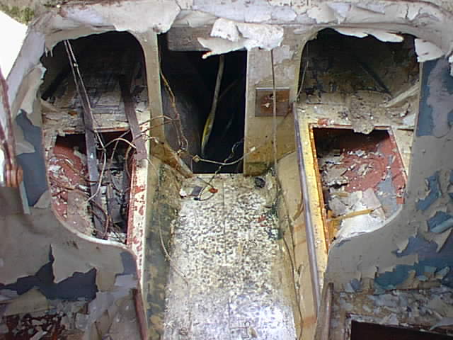

I am trying to determine if I need to cut my losses, admit I am just another guy that bought a boat that needs too much work/money to make it sea worthy or if it is viable to restore.
Brett,
In case you think your O'Day might be way too gone to restore, here is an example of how much can be done.
Take a look at these videos from Boatworks Today (www.BoatworksToday.com). This is someone who is a professional and in these videos has taken possession of a Rhodes 19 in dubious condition. He is going to restore it for his own, not a customer.
507
Catalina 310 278 Lyndeborough NH

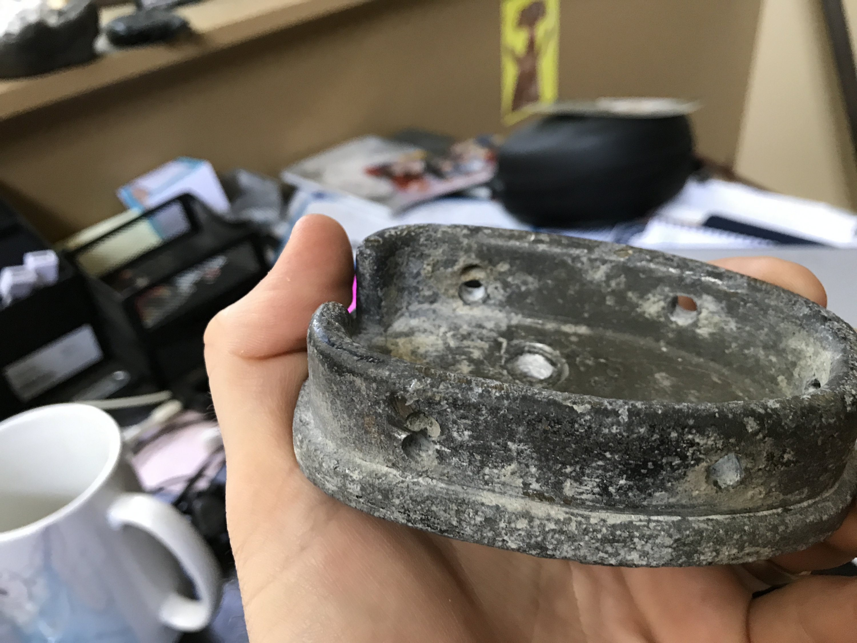

Quick update from last year. Finally working on this issue. I can't use the Catalina 22 block to raise the tabernacle. It is too narrow so I am going to cut and order shortened stays - I need them anyway.
My next question is my mast step casting. It has holes it it that look like they are worn out and too large. See pic.
Drmarine doesn't seem to have a replacement although I am going to call. They have one for,the 192 but not sure if that will fit.
Am I ok with mine or is it smoked and I need a new one?

It's fine. the holes are only there for the rivets that hold it on when the mast is down.
Use bigger rivets or ignore those and drill new ones.
13,999
A skilled welder might be able to fill the holes with aluminum. Then drill new holes.
24,522
Brett..It looks old and crusty, but looks like it will still do the job. You can make it pretty. Take it to a local machine shop that also does coating. You can have it cleaned up then powder coated. It will look new. Did that to my mast step last year.

Thanks for the replies. I called drmarine. They had one- 22 bucks.
