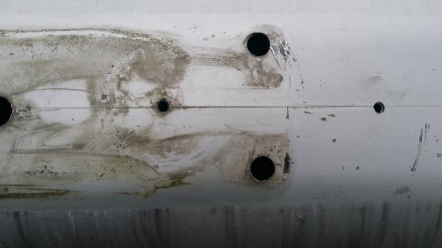

1982 c25 the mast has developed a couple of hairline cracks 1 at the base and 1 above the spreaders, anybody had luck with tig welding these masts
Will add some more well defined pictures tomorrow when u get back to the boat.<img src="http://forums.sbo.sailboatowners.com/attachment.php?attachmentid=89153"/>
Catalina direct tech support is very intrested in seeing these cracks as they are along the seem and haven't sold any replacement masts in several years. And the ones they did sell were for complete failures not this type of hairline cracks
They can be TIG welded, and if a person is good and knows his equipment well, it could be MIG welded... but afterwards it would need to be anealed to releave the stress from the welding.1982 c25 the mast has developed a couple of hairline cracks 1 at the base and 1 above the spreaders, anybody had luck with tig welding these masts
I agree that wrapping it is a good tempoary fix, but not so good as a long term repair for thin aluminum. The flexing of the mast will soon get to the rivits and losen them in their holes, and you will be back to where you are now, only with more welding to do.
Welding it properly and anealing by someone who really knows metal and the how to remove the static stress from it, will most likely give you a permanent repair that will last until something more severe happens to cause other damage.

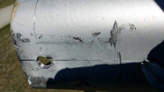

More updated photos. I currently have planned to get the (seem separation) cracks welded by a professional tig welder on Friday. The cost of a replacement is 3000.00 shipped from catalina direct. The boat was sailed in the rockies mountains and subjected to high shifting winds and severe micro bursts ( ghost lake, for a reason!!!!!)<img src="http://forums.sbo.sailboatowners.com/attachment.php?attachmentid=89179"/>

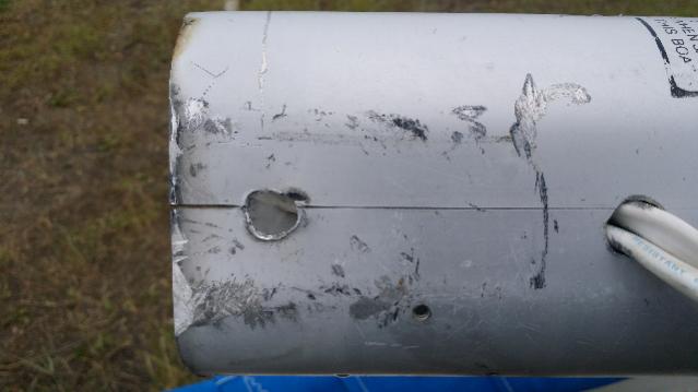

<img src="http://forums.sbo.sailboatowners.com/attachment.php?attachmentid=89180"/>

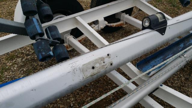

<img src="http://forums.sbo.sailboatowners.com/attachment.php?attachmentid=89181"/>
<img src="http://forums.sbo.sailboatowners.com/attachment.php?attachmentid=89182"/>

I appreciate all the comments so far, I just can't full understand why it would have separated on just the 1 side???
Well... its a good acceptable idea on boats that are designed to have shorter masts... but in thinking your suggestion thru to the end, if one was to cut their mast off 8 inches, then they need to shorten the rigging also so it fits.... and the boom will be lower in the cockpit and the jib may have to be shortened so it has clearance on the foredeck....Cheap fix: Sawzall the bottom and have a six or eight inch shorter mast. At the spreader: how about bolting on a plate?
Just throwing around ideas. I have no idea if it would be acceptable to have a shorter mast.
