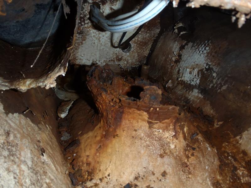

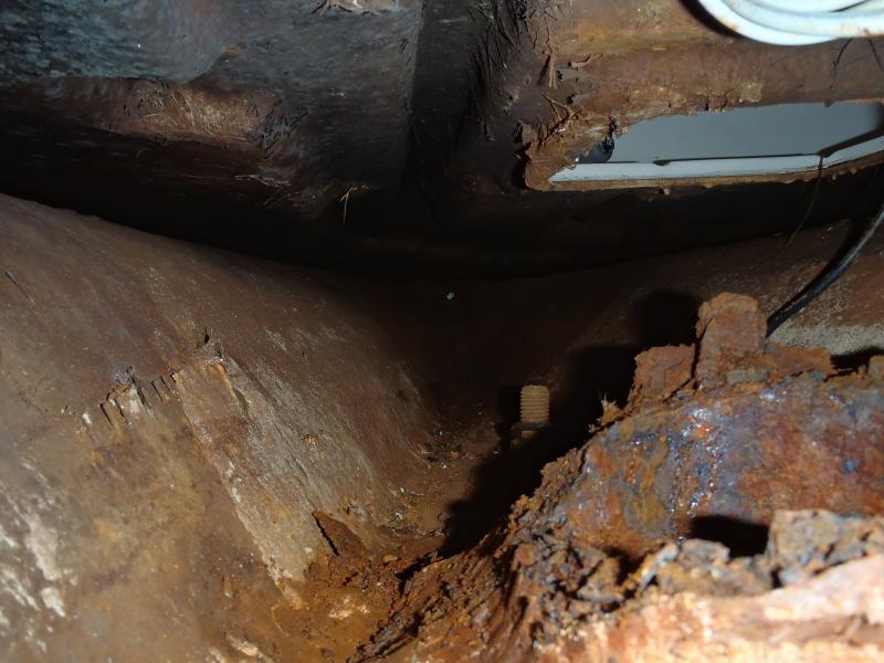

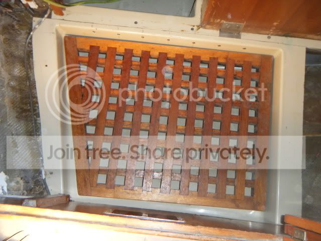

Anyone else replaced their rusted out compression foundation in the bilge? I am planning on using a bottle jack and placing a 4X4 in place. The 4X4 will fit inside of what is left of the post. Question: Should I use a saws all or hacksaw to cut through what is left of the pipe and glass so that I will have a flush foundation? The boat is a 1981 Hunter 36 that took on rainwater through the engine cover. 8 inches to be exact. The PO lived out of town and could not save it so I got a good deal. Then on days like today I think of selling it. this after a TOTAL rigging job and thousands dollars spen on a new rudder and bottom job. Any thoughts?

This is what it looks like

Rake out everything that is bad so that we can see what's left. Doesn't look too bad to me. After you get the mess cleaned out build up a new mast step with pressure treated lumber. Turn a new mast base and bond the whole works with PL Premium polyurethane adhesive.

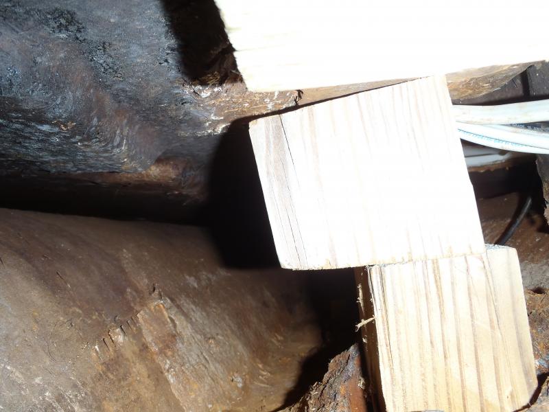

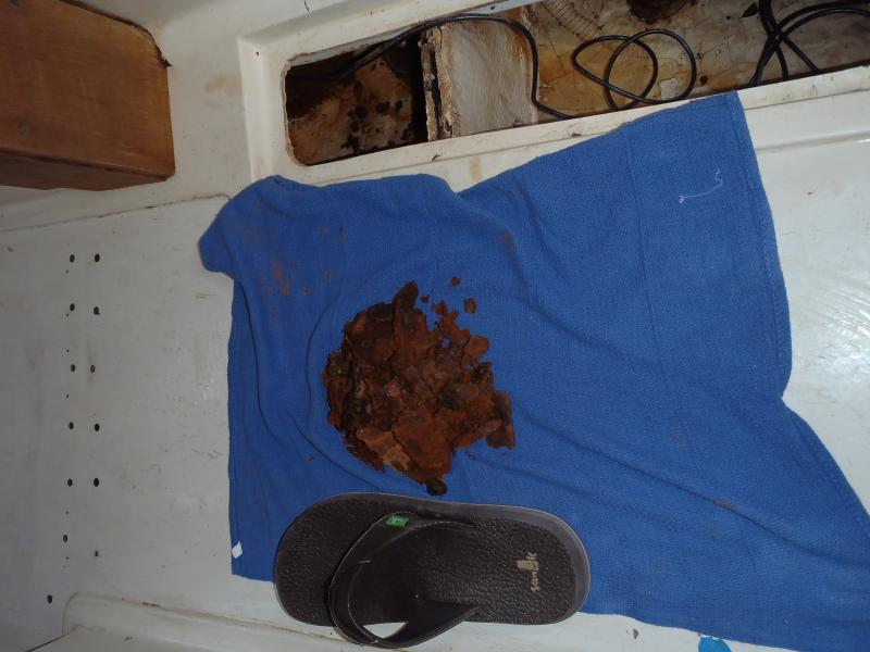

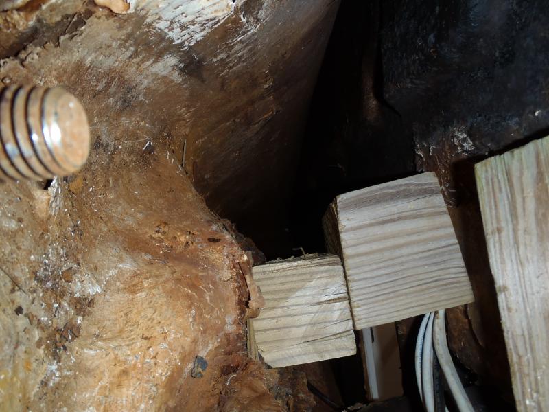

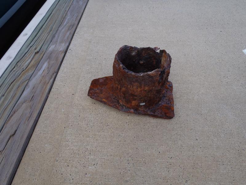

I am VERY impressed. I am a perfectionist and ashamed at the pictures that I am about to post. Today I realized that in order to do the job right I must get the mast pulled. I used a bottle jack with a small piece of wood to evenly distribute the load. Here is what happened today in order: 1. I loosened the rigging. 2. Vacuumed all the left over rust 3. placed the bottle jack and raised the sole/floor. 3. cut a 4X4 to fit in what was left of the the base compression post and cut a second piece to fit between the bottom 4X4 and the flat piece of glass underneath the sole ( fiberglass between the compression post and the piece of metal that rotted away in the bilge) 4. I pulled out the jack 5. I tightened the rigging Before I tightened the rigging there was maybe a 2-3 mm gap between the two pieces of wood. After tightening the rigging there was no gap. This is a temporary solution and I would like to stress to all: The bilge is dry where this is located. This probably wouldn't have rusted/given away if it wasn't for the 8" of rain water (seeped in due to the cockpit drains being stopped up with oysters/barnacles, engine cover gasket gave way, float switch failed) that sat in the boat for a month. That is when I found the boat and offered a the PO a good deal. I feel like selling the boat now...?????? Any takers???? Nah tomorrow is a new day and the beer eased the frustration so that I may have a little more time to think things through. Thanks all I will keep you posted.
