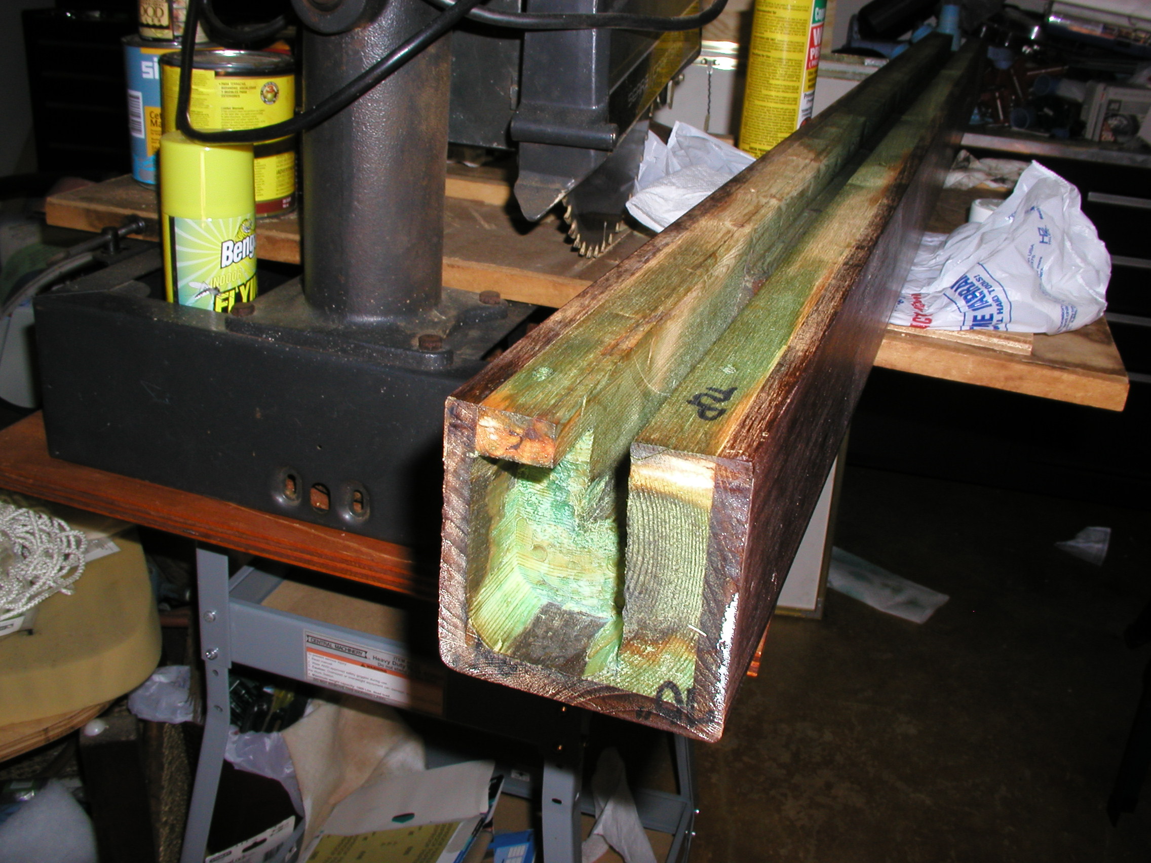

This shows the base of the compression post on my Hunter 27. It appears to be a pressure treated 4x4 post that is clad in teak plywood. My post is in good shape, but if I had to change it I would replace with another 4x4 post. Seal any leaks, push up the ceiling a bit, and cut the new post to length. I would not mess with a metal adjustable post except maybe as a temporary jack to raise the ceiling.

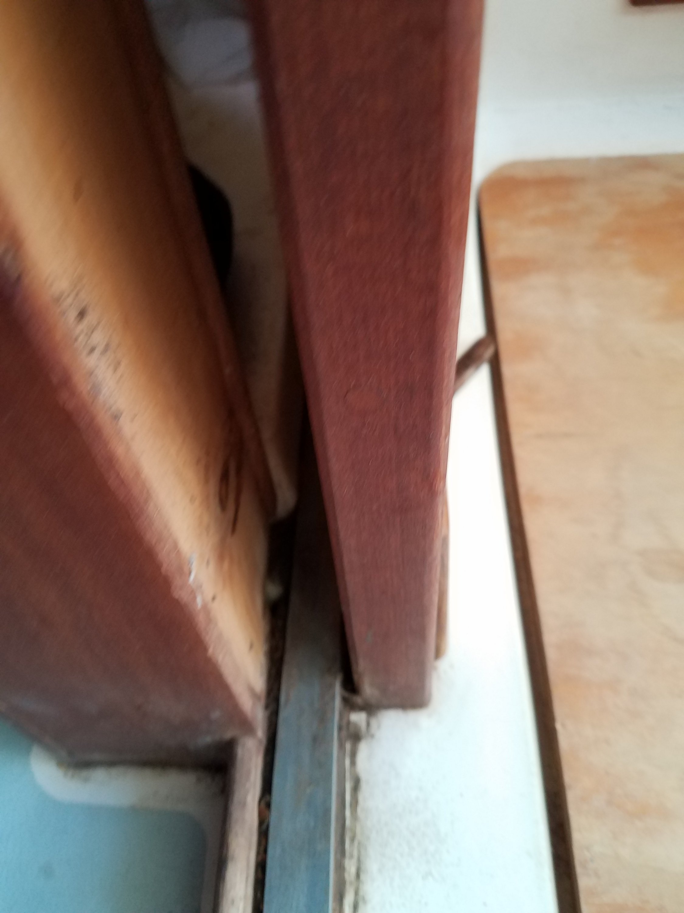

9,225
Attached picture shows the original marking on my post, on the bottom right corner. It is marked 70 inches and when I measured it, that is the dimension I found. .. Mine had rot only at the very top so I removed the rot and carved a plug to replace the rotted stuff.. The green stuff in the wood is copper naphthenate, a wood preservative that I soaked the interior of the post in to stop any further rot. I don't think I'd use one of the adjustable jack stands.. It would probably be OK; I just cringe at the thought of something that could possibly unscrew ..
