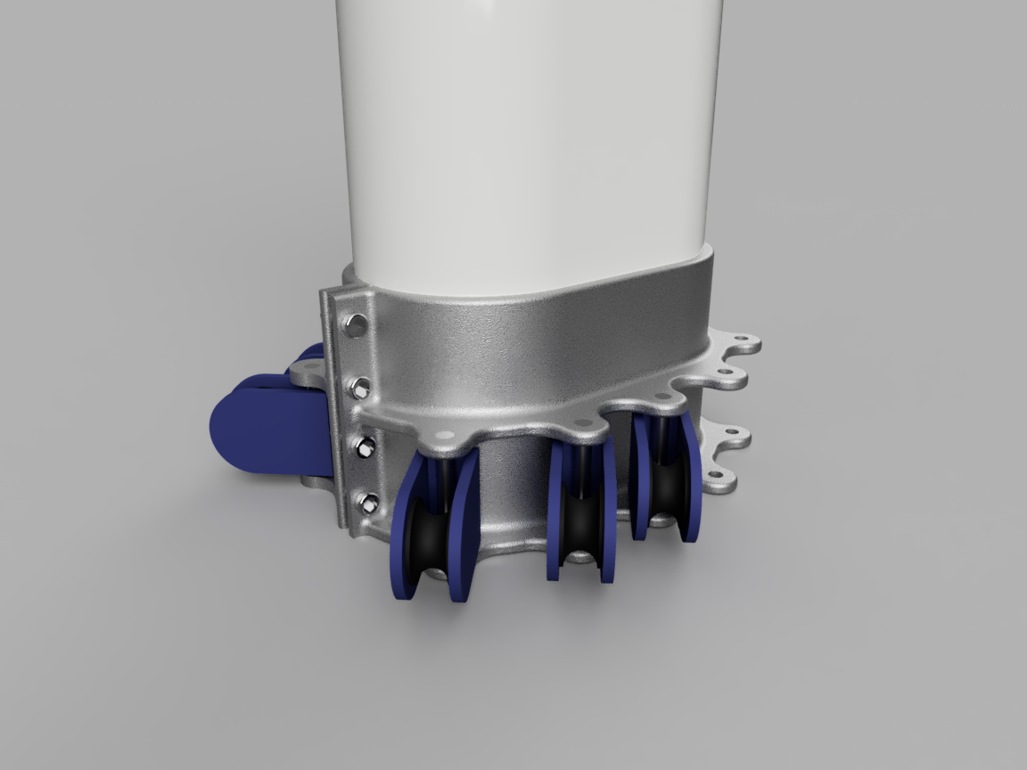

Here is a quick mock-up I just made to show what I think I recall. Something like ...
I will likely just end up unstepping and installing a mast plate. But, just looking at stresses, the collar is a stronger design and I love the idea of being able to remove, repair, inspect, and modify without unstepping.

Forces in play... remember this term when you're narrowing your choices. The plates mounted under the mast are held down by the mast AND its shrouds. Halyards create lifting force. Many keel stepped masts have a hold down turnbuckle that is attached to the overhead and captured by a mast mounted pad eye. Since there is no mast on the cabin top, there is no down force. The turnbuckle holds the cabin top down against the upward pull of halyards.Attaching blocks to the cabin could work if you through drill the cabin top and use a robust backer plate. Attaching to the mast might also work if the block is thru bolted.You could have blocks on either side. Attaching to the bolts would require a tang of some sort. Again the tang needs to sized to overcome the forces against it. In the pic, the block collar looks to held in place buy compression. There is a possibility that the vertical forces might pull or allow the collar to slide up. To counter this, I'd suggest thru drilling and thur bolting in that area above the ledge in the casting.

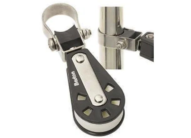

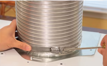

13,088
These are designed to go around stanchions (search for stanchion turning block) and you could attach to the mast using SS hose clams (from the plumbing section of Lowes)
