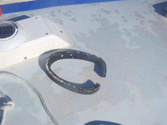

Just took mine out and used spartite to reseal it. Mast doesn't leak for the first time since new. It is a two part polyurethane that is the same material as inline skate wheels. Just dig everything out the top, clean it, wax it or use another releasing agent, and pour it in. It sets up in fifteen minutes. Make sure you seal the bottom. Modeling clay worked well.

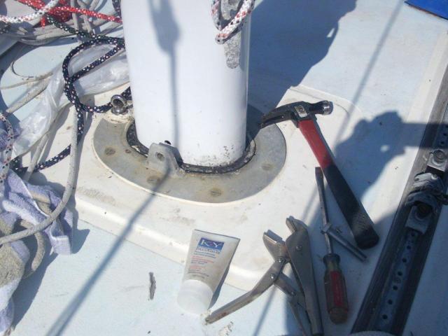

I just got my mast back in. Was dreading driving that split rubber ring in as mast was up against front edge of partners. Cranked down on back stay, lubed the ring with KY jelly, and drove it home. Whole thing was 30-45 minutes. Yahoo
Jun 2, 2004
5,802
That thing is a bear alright. I usually have to have loose shrouds and loose stays. Then I have someone pull the mast side to side and fore to aft while working it down. I use a heavy rubber mallet to beat it in. But loaded up with clear silicone I have never had a leak. So you are done and ready to go sailing?
