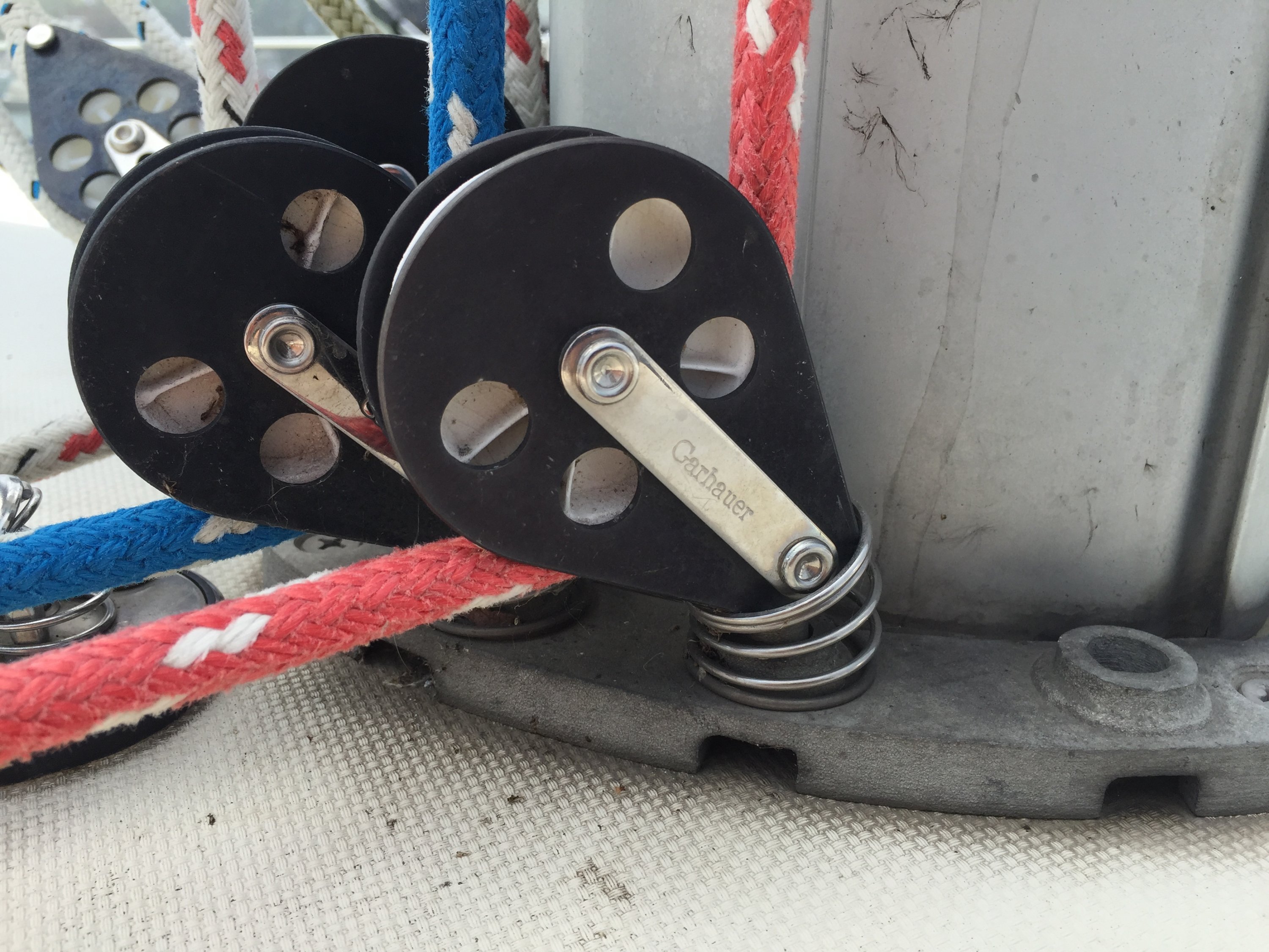

I have a few turning blocks at my mast base that I'd like to replace (since the 25 year old sheaves are starting to deteriorate). I have found replacement blocks online, but before I purchase, question is how hard is it to replace blocks in this style of base? See attached picture. It's an Isomat NG31 base with 12mm holes. The block pin fits through the base hole into the nut. However the nut slots are pretty small so using a wrench is out of the question. Is it just a matter of jamming a screwdriver in there to hold nut? ...or some other trick? Surely there's something short of removing mast and plate that will work.

it might be a good idea to get in touch with rig-rite, to figure out how it works as that is their product....
23,534
Also try Garhauer. With that picture they should be able to help. The springs on the blocks seem unnecessary.

I replaced mine a few years ago.... Nuts stay in place. I put a wrench on the old block and turned.
Well that's too simple, obvious and convenient for me to have even tried. Will give it a shot next weekend - thanks.

Springs are to hold blocks upright when lines are slack.
