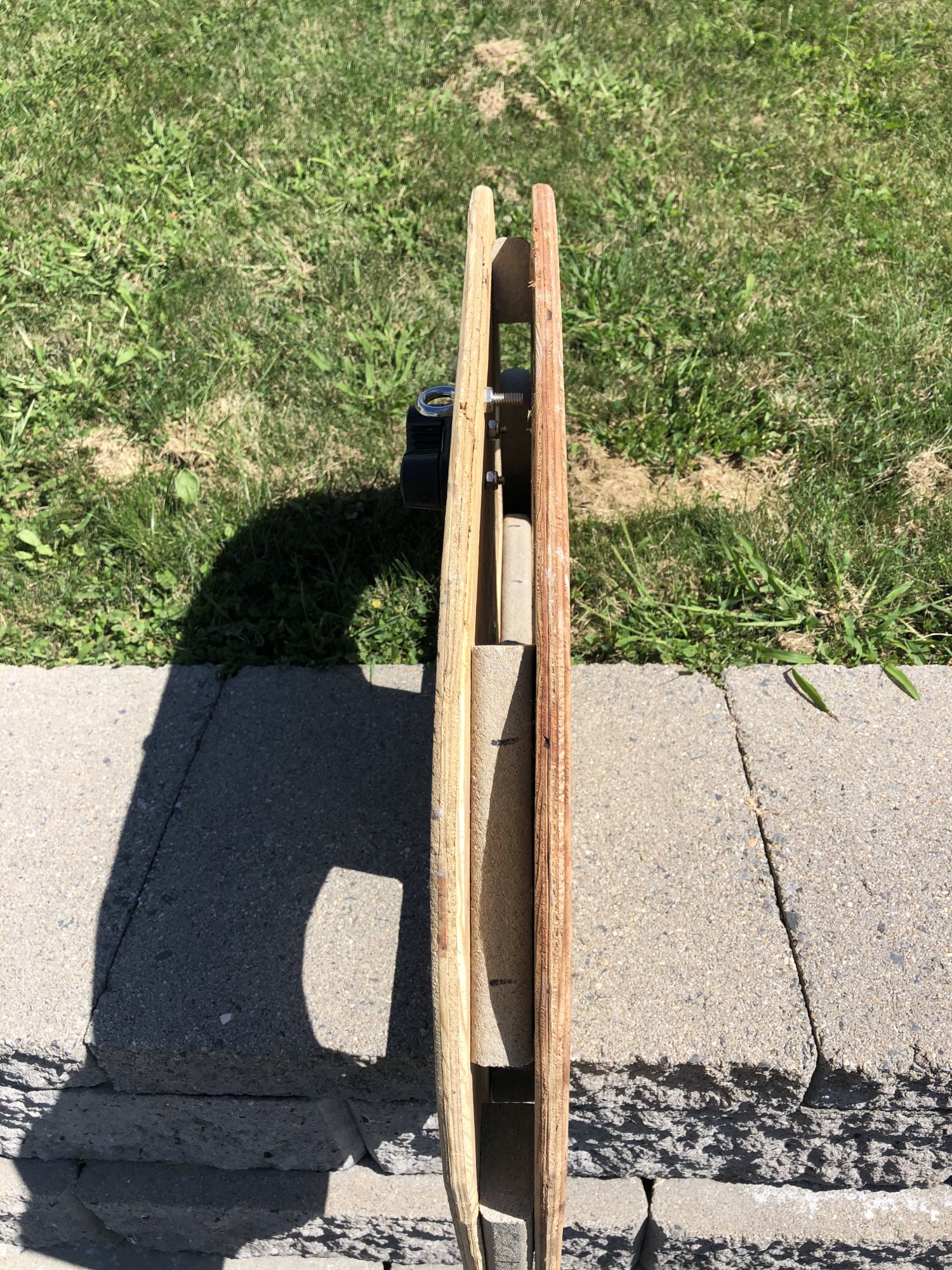

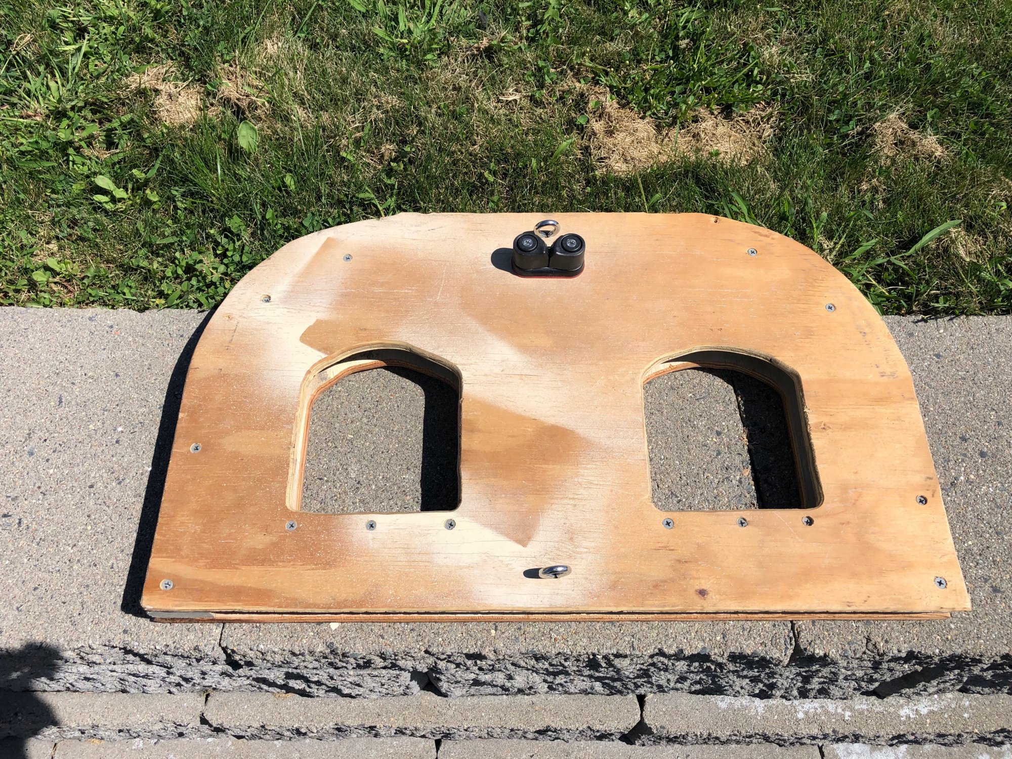

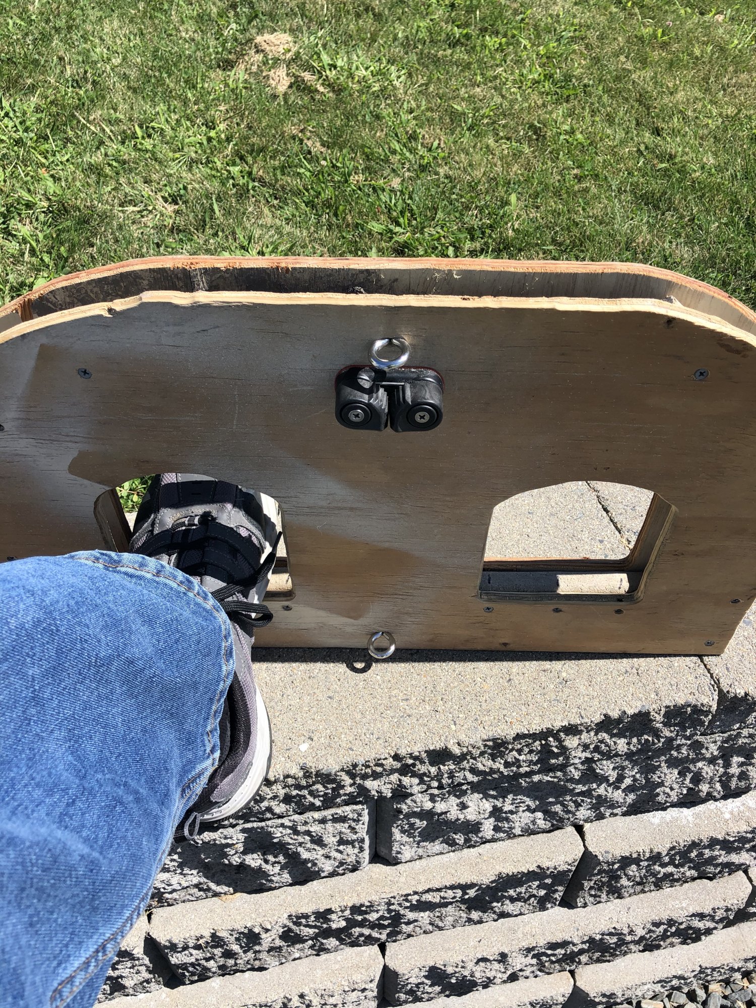

Smokey, the board is home made. It is aboard my boat. I'll try to take a pic tomorrow. Essentially it is 2 pieces of 1/2" CDX plywood. They are mounted together with 5/4 strips of composite deck boards. The shape is like a piece of bread. There are foot holes on each side of the center line. At to top centerline is an eye bolt. Immediately beneath is a cam cleat and another eye bolt at the bottom edge.
The process is: Run a halyard thru the top and bottom eye bolts and try it off. Winch that line tight. Sit in the seat and place feet into the holes ( cut outs actually). As you lift the board with your feet it rises and locks on the halyard with the cam. At the end of the stroke ( limit of leg lift) you stand and off load the the seat. your deck mate takes up the slack in the seat halyard. You sit back into the seat and repeat the process. All of you lifting is being done by your legs.

Thanks @sailme88 What I imagined. I like the two pieces of plywood with the spacer in between to keep the weight down but provide some surface area for the foot.

I forgot to take a backside pic. What it would show is a flush surface. All screw are slightly counter sunk to avoid making contact with the mast..

@sailme88 I like the climbing board but once you get to the top and do your work, how do you get the board back down. It seems the cam cleats would lock the board at the highest level you reached? Any trick would be appreciated.
Holding the board in place with my feet, the line is eased out of the cam and will slide thru the eye bolts..
