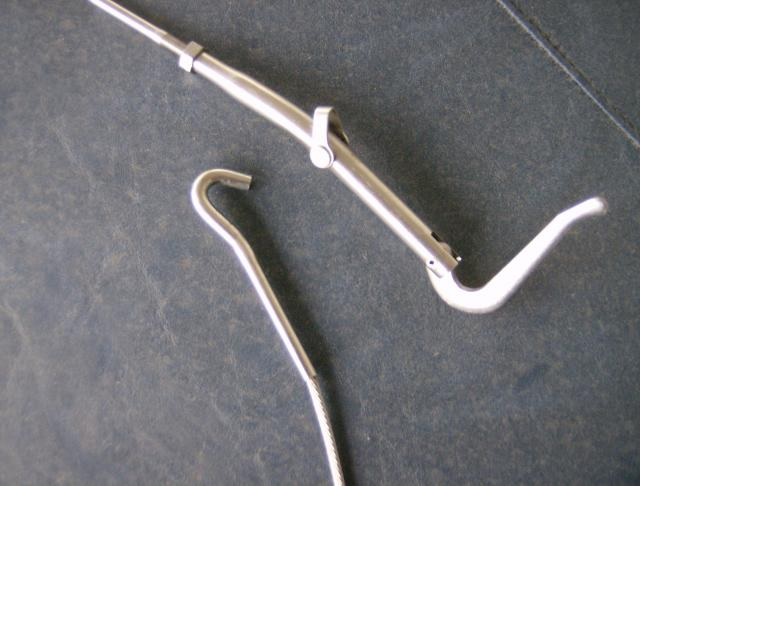

Twalker is correct that the 260 which came with the struts eliminated the removable bridal wires which were solely used for stabilizing the mast when raising and lowering only on the 26 and not the 260. Therefore, the length mentioned to bridal wires is only for the 26.
Originally, Seco South made the wires but I bet you Phil probably can do so as well. One end is a T toggle and the other end is a pelican hook. I would suggest with the mast up noting the length from the hole of attachment on the mast to the stanchion where attatched and allow a little more so they will not be taunt with the mast up. Hope this helps you sir.
