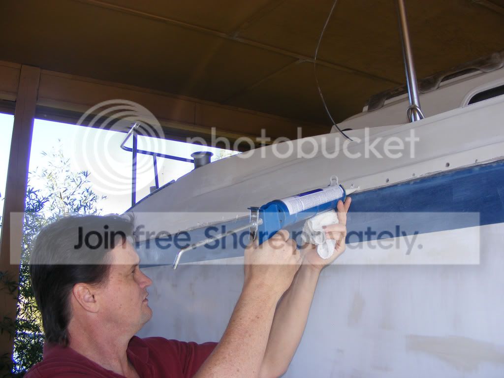

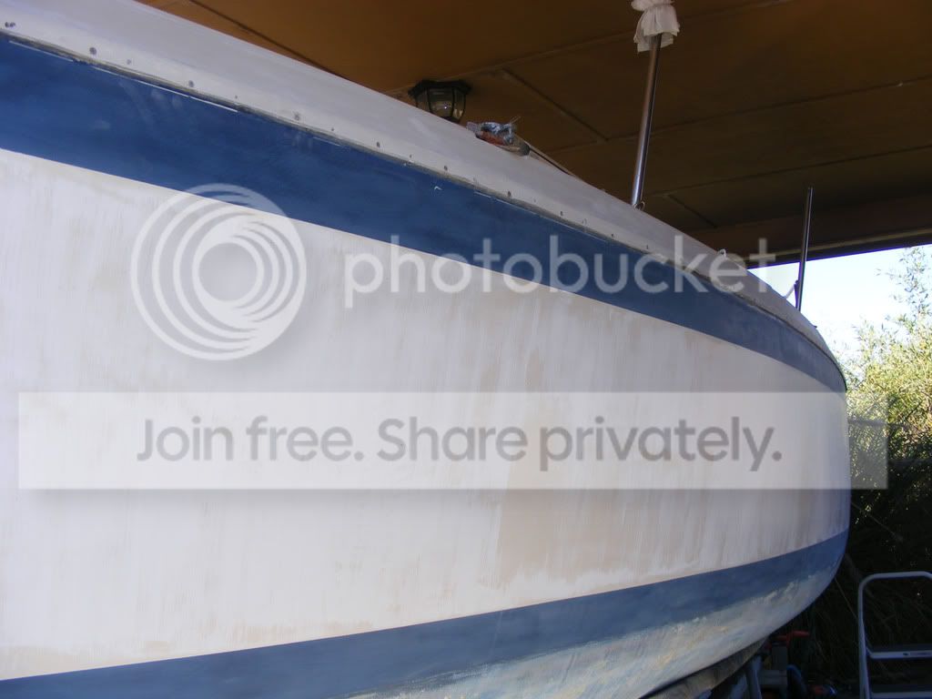

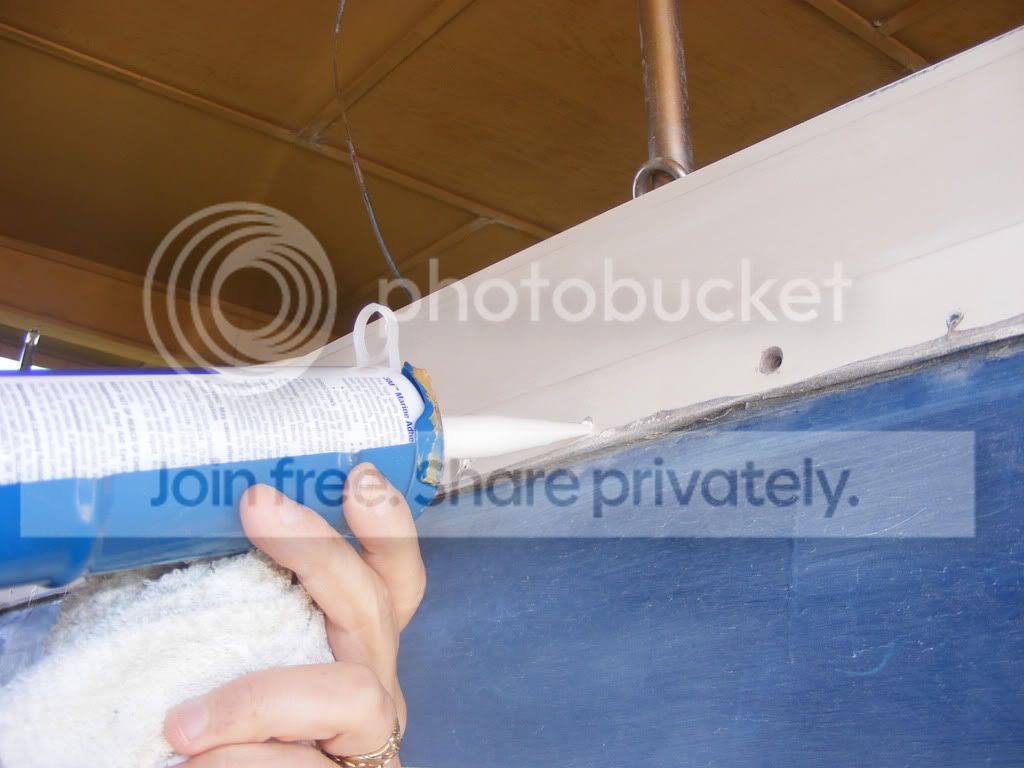

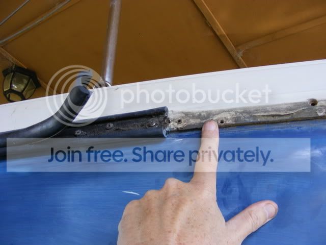

I did this in the last few months. Once you get going, it is really easy. I had an after market rubrail on my boat from the PO. I am replacing it with one from Rudy.
Expect a LOT of screws, I mean a LOT!!! Expect some serious grime under the rub rail.
Sand the area well and clean out the holes well.
I left a few screws in. I was worried I would get some bad weather and I got cold and wet for about a month. I was paranoid that with them all out that the wind could catch the top and slightly shift it from the hull. Probably just over carefulness.
Caulk the holes, I used 3M 4000uv. One tube filled all the holes.
I am about to paint my boat and then will install the new rubrail.
