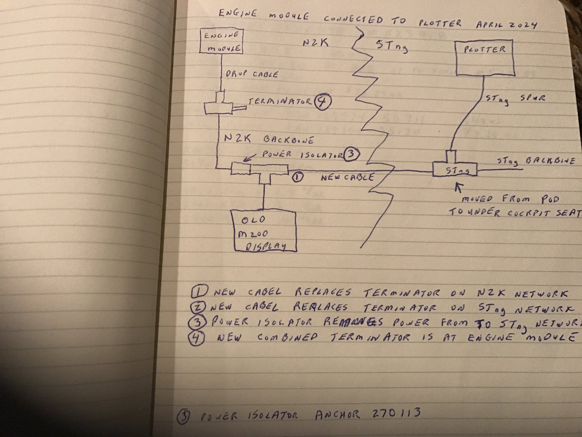

Three months later and the display is blank again. Time to hook the readouts up to the chart plotter.

The original instrument had a horrible UI, and the display was unreadable
Yes, hook up the N2K feed to the plotter.

Instruments are now hooked up to the plotter which is a much better solution.
