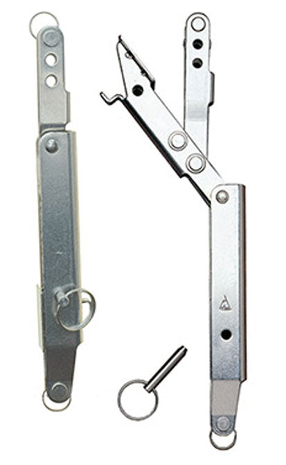

You could use a forestay lever. I can't imagine rigging a trailer sailor without one. If you have the correct fittings, I don't see why you couldnt use it on the backstay
