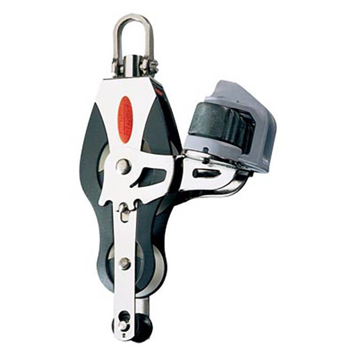

With my Mariner, I did 2 things:
  • base plate for the mast. However, have to be careful when lowering the mast - a cleat at the bottom of the mast slot will hang up on the base plate when lowering the mast. Ask me how I know.
  • replaced the useless v jam with a block with a cam cleat. Wondered if I needed more purchase, but it turns out the 3:1 with a proper cam cleat works just fine for me.
I've never seen or heard of a gnav, so can't help there. The modified vang works just fine for me, even though the angle is still pretty bad. Money being no object, I would have replaced the top block to get a 4:1 purchase. Vang gets removed for trailering. Here's a photo of the new lower block for the vang.
