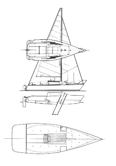

When I first read the OP I was thinking the Triton 21 was a stretched Ensign. But SBData shows the Triton 21 as an entirely different boat. It is a nice looking boat with a lifting keel as opposed to the long keels of the ensign and electra. SA/disp. a fairly sporty 24 and a little cutty cabin. If you have found one in a condition you accept at a price you accept you should buy it.
It's hard to tell why there aren't more Triton's around. The boat just might not have found a niche in the market. Search for other 21-24 foot boats that came out in the mid 80's and you might find the answer. The J 22 came out in '83.

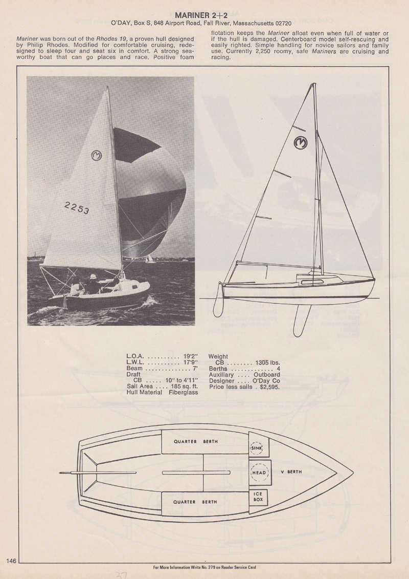

I am a Mariner owner, myself, and a huge fan, but that Triton looks like a great boat too. I'm unfamiliar with it.
Just from what little I can see, I'd recommend you ask yourself, what you want out of your sailboat. Both boats will sleep four, not too large people, but the Triton looks a bit more roomy of you don't like small births. The triton has more modern lines and probably sails like a banshee, maybe even planes under the right conditions.
The Mariner is the Rhodes 19 hull, a fast, proven design from the mid-sixties, but probably a slower design than the Triton. I know the CB version of the Mariner will launch easily at most any boat ramp. She typically weights in at just under 4000 lbs.
The Mariner has the largest cockpit for a boat of her size, at 9' in length, making her a great boat for friends and family to join for day sails. The other advantage to the Mariner is availability of parts. She still being built by Stuart Marine in Rockland, Me. And the Class Association is active and holds class events. There are a number of member in Florida.
Good luck, this is a tough decision.
-Will
