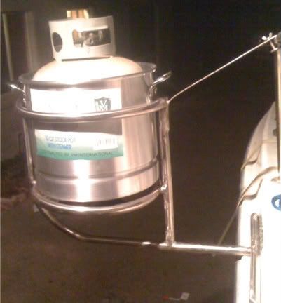

One of the reasons I got a sailboat was to take it crabbing.
I feared in harbor/no wake zone speeders and a couple gallons of boiling water on deck would create a disaster.
I decided to build a stainless turkey fryer/crab&lobster steamer for the boat.
Tools/Material:
- Appropriate wire and gas for welding stainless.
- 304 tubing and flat stock
- Harbor Freight Tubing Roller and Notcher
- Tamale pot large enough to stow the propane tank.
- Burner from my existing setup.

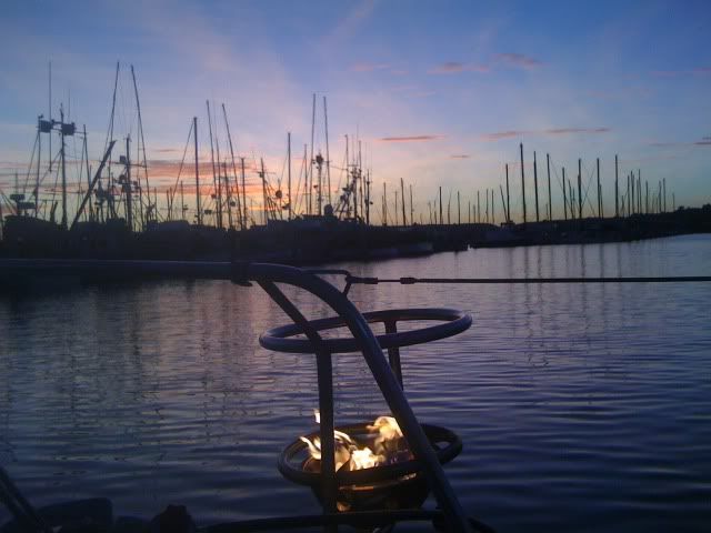

- Large stainless mixing bowl for a flame guard
The burner and flame guard have not yet been installed.
The notcher needed adjustment and spacers to work correctly.
The 1/4" set screws slipped and stripped on the roller.
I drilled, tapped, and replace with 5/16" screws and it has worked well since.

I love the idea of using a large pot as a propane tank holder. With proper refinement it could even be used as an inexpensive solution to install a propane tank locker in an older or smaller boat. A hole can be cut at the bottom to attach a hose to provide a vent to the outside via a through the hull. A hole can be cut at the top to attach a vapor tight fitting for the supply line. And a lid can be fitted with a gasket and held in place by clamps. Metal rubbing against metal could produce an unwanted spark so the tank would need to be restrained inside the pot by a non metallic brace or liner. With propane tank lockers starting at $500 not many small boat owners can justify an installation but large pots are rather inexpensive. Just throwing out the idea, it does need some refinement but I believe it could be done.
