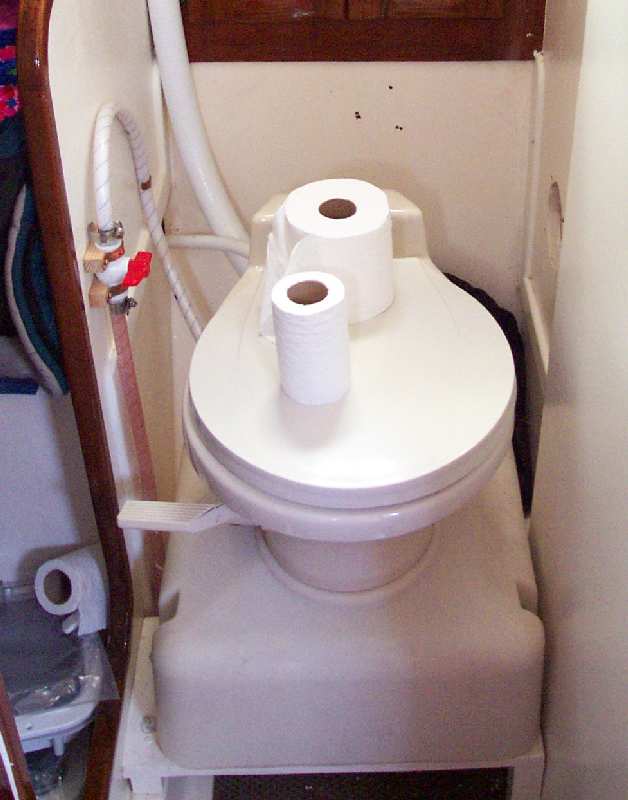

Btw, if there's enough floor space in your head for the 20x-20 tank footprint, check out the Dometic/SeaLand 711-M28 "Marine Traveler"...an MSD portapotty on steroids! :) Defender has the best description of it: SeaLand Traveler at Defender
I have had one of those for 12 totally trouble free years. I did install a fresh water shut (red valve on the left) so you can aim for the hole (I will NOT elaborate) with no water running - this conserves a lot of ullage.
At pump out time you can rinse the tank insides until it is totally clean.
Anything that can't be pumped out can be harpooned and removed.
You can see the level through the translucent sides
The new ones have about 50% more capacity than mine.
A good solution if you have the space.

It has the same 9.5 gallon capacity it's always had.
There's a water valve on the back of the bowl that control flush water. It starts water flowing when you either step on the pedal to flush or lift the pedal to bring in water without opening the ball, stops it when the pedal is released. Those are the only times water should come into the bowl, so there shouldn't be any need for a shutoff valve in the water line. If you had to install one, the water valve has failed and should be replaced. They have an average lifespan of about 5-6 years, so it's not surprising that you'd need a new one.
A lot of what???
Adding a few inches of water to the bowl ahead of solids will keep the bowl much cleaner.

Use imagination on why you might want the flush open with no water running.
Ullage - The word comes ultimately from the Latin oculus, “eye”, which was used in a figurative sense by the Romans for the bung hole of a barrel. This was taken into French in the medieval period as oeil, from which a verb ouiller was created, to fill a barrel up to the bung hole. In turn, a noun ouillage was created, which was the immediate source of the word's modern form, first recorded in Norman English about 1300, at first in the sense of the amount of liquid needed to fill a barrel up to the bung hole.
Ullage is also widely used in industrial or marine settings to describe the empty space in large tanks or holds used to store or carry liquids or bulk solids
You are never too old to learn.

Ullage is not put in the bowl, it is put into the tank by emptying it. (It is the empty space in the tank):biggrin:
One perfectly genteel use for that valve is to cut the feed water off during pump out so one can have the flushing valve wide open without having fresh water running in. This also allows the ingress of a virtually unlimited amount of air, enhancing the efficacy of that procedure.
Another is it just gives one more control over how much fresh water is used. After 10 + years we have learned to play that toilette like a fine musical instrument.:waycool:You are right though, it is not absolutely needed.
On a more serious note I do recall at one time being disgruntled to read that newer models have a 9.5 gallon tank and ours is just 6.5 - in any event that would be moot since who would want a smaller tank?
