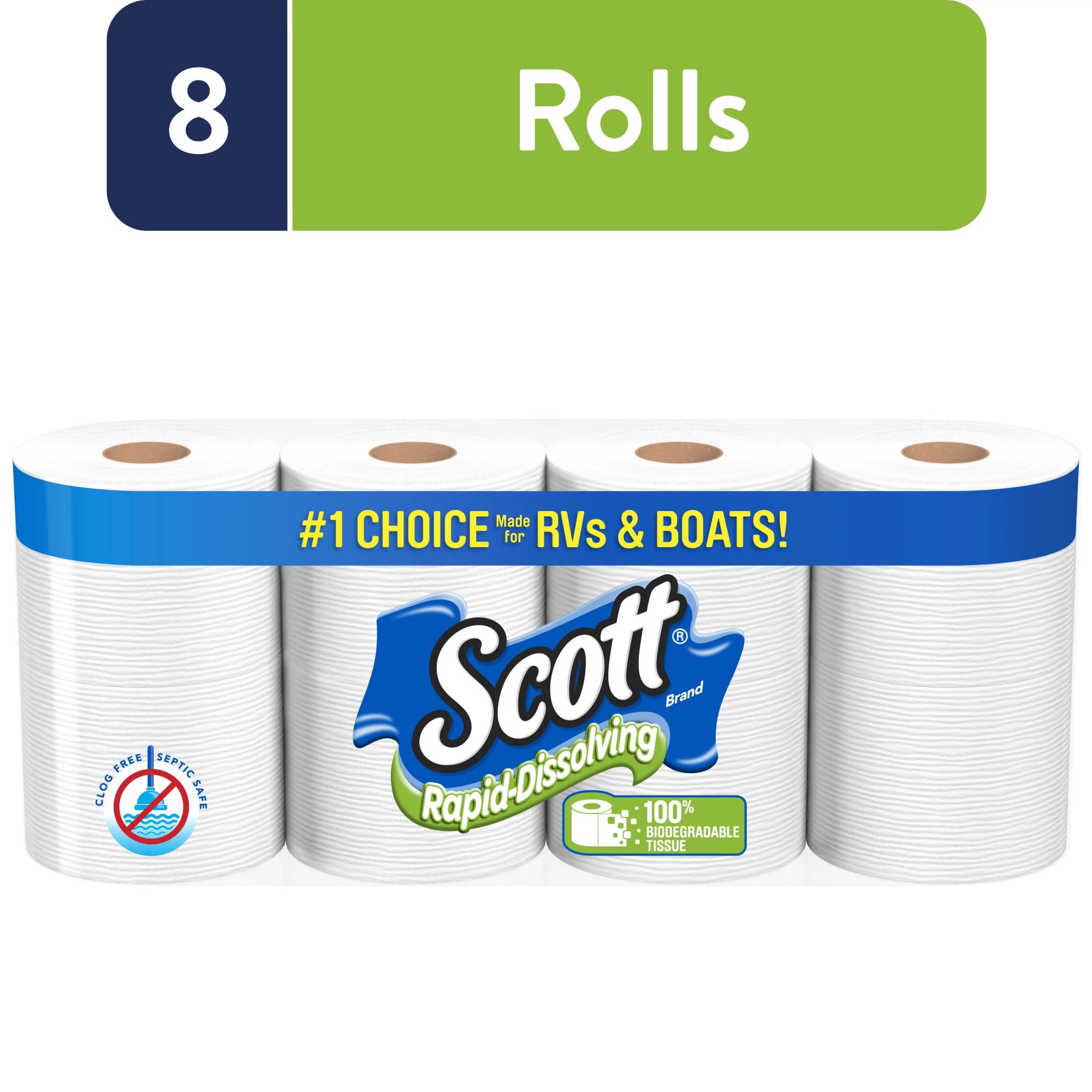

Isn't that just about the same as using these ...............
............ to wipe your .................... never mind :facepalm: .
No, Ralph, it's not! Marine TP is cheap enough to not worry about the cost. As a matter of fact, per-roll, it's cheaper than regular Scott's TP. Of course, you can always use your hand, and then wash your hand after every poop, if you're worried about the cost.
