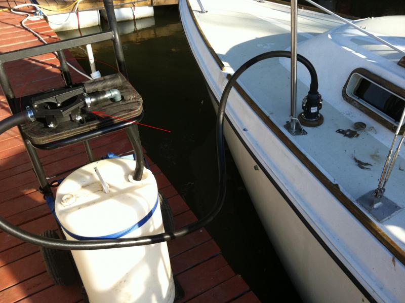

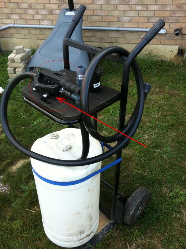

I made my own "waste caddy" using a diaphragm pump, an old hand truck, and a 10-gallon jug. A little welding, some 1" dishwasher hose, et voila, independent pumpouts at our dock on the river! Dumping the jug involves a 2" dia 5' hose, threaded onto jug, fed into throat of my toilet at home, and pour away. That part's not nearly as fun as the pumping part.
