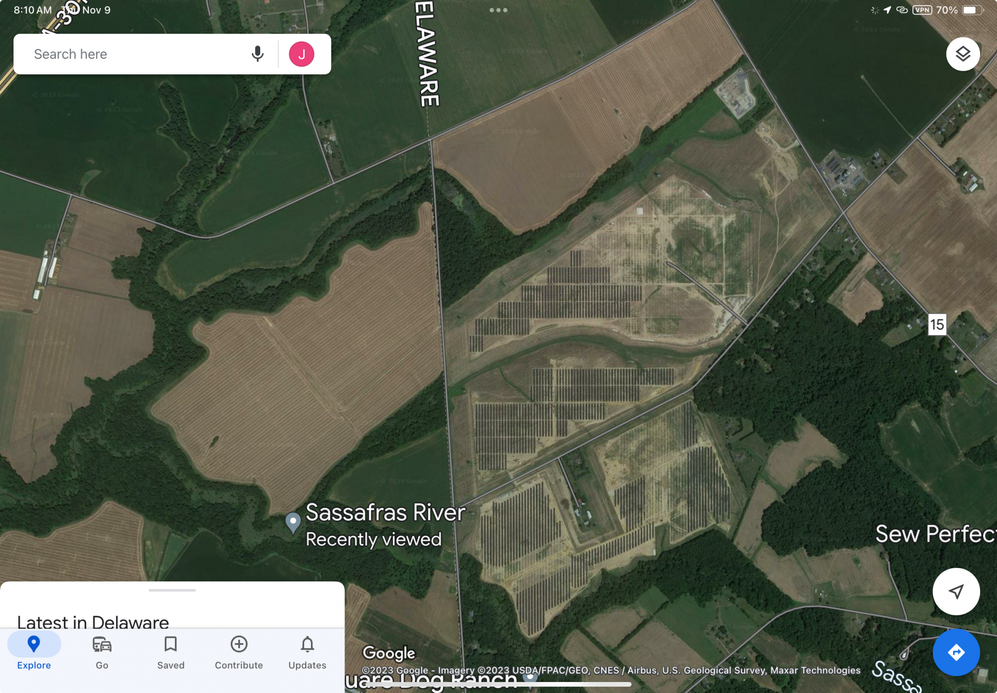

Sure it could be temperature… Climate is not a sudden change agent. It takes decades of weather changes to show a sudden change in the environment. From the way you described the issue, it sounds like this is a more sudden (24 months) type of change to your boats bottom. If it is a concern I would look towards upstream development that might be causing an impact on the stream. You could start with stream temps. Do the local jurisdictions manage water sensors on the river? In addition to temperature you should look at chemical run off. Fertilizers from housing developments. I note that google shows a major solar panel farm in the Sassafras River water shed near the Square Dog Ranch. They have denuded the fields to install the panels. Not sure if they used herbicides.
The river appears to be a popular area with housing development along the river. All of these sites generate stormwater runoff. Where does the runoff end up? Is it treated to remove the fertilizers and other contaminates or is it dumped into the river.
It would be wonderful if we could name one thing that is a cause, then we all could get focused on that culprit. In reality it is often many things that together create a cumulative change to what we call the “norm”.

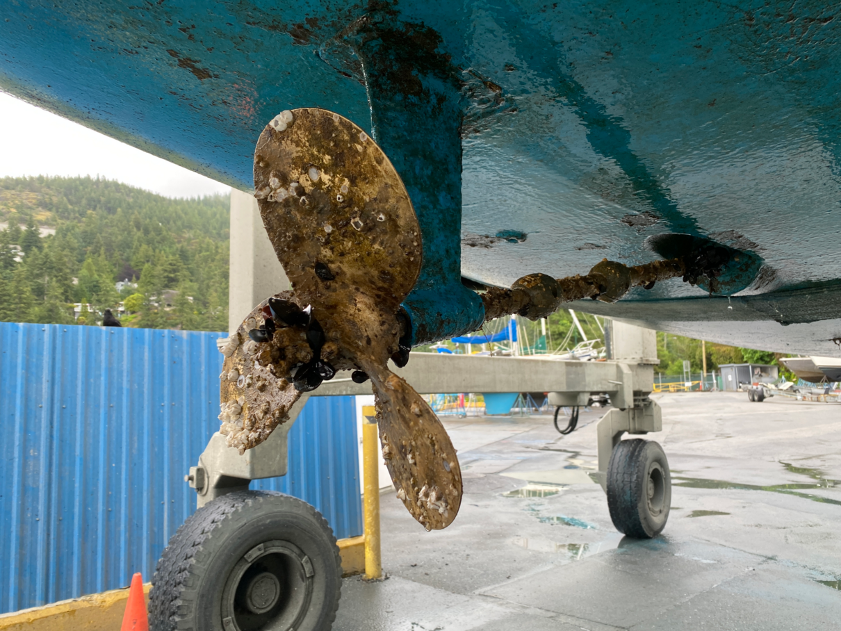

Based on my less than zero knowledge of marine biology, I would say that :poop: sometimes happens. Normally my underside has little to nothing to offer and looks like this after not moving all winter

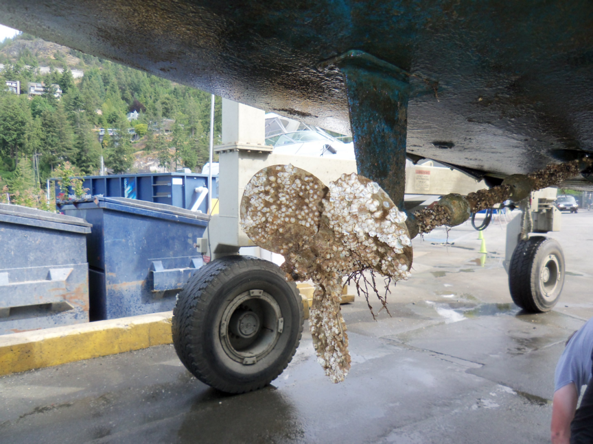

Then in 2018, it decided to look like this for no reason whatsoever
Different type growth moved into the neighbourhood that year although they still didn't like the ablative on the hull.
Wait until next year and see if there's a difference before you get into anything like weekly bottom scraping.
