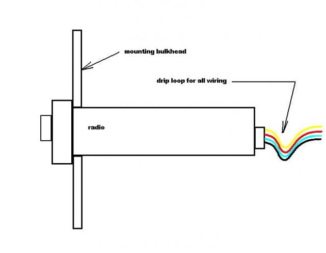

Another point. For any installation, using a marine radio or a car radio, moisture is still a problem. The three most common entry points are the face, the top of the case, and the wiring.
Mounting the radio in an out-of-the way location is an easy way to address the face and the radio top, to prevent water from getting in. Many marine radios have significant protection from water ingress in these areas as well. Water has an uncanny ability to travel along wires though. If you will bend your wiring going into the radio so that it forms a drip loop as shown, you will help prevent water from getting into the radio from the rear.
