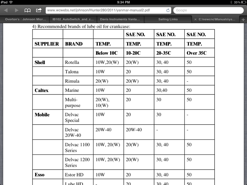

This is from the Yanmar manual
Greg
Greg
Thanks, Greg. I decided on the Rotella SAE 30 for the engine oil and Pennzoil 80W-90 gear oil for the tranny. I looks like a winning combo (I hope!).
