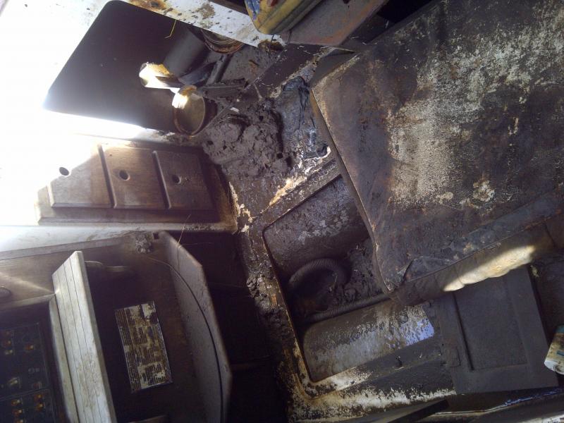

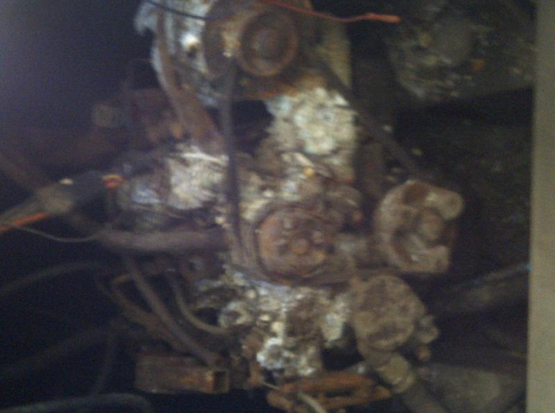

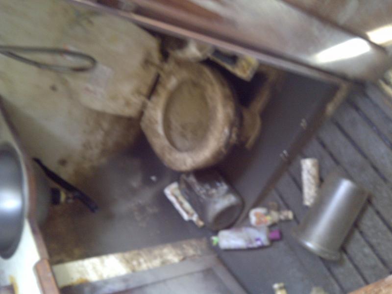

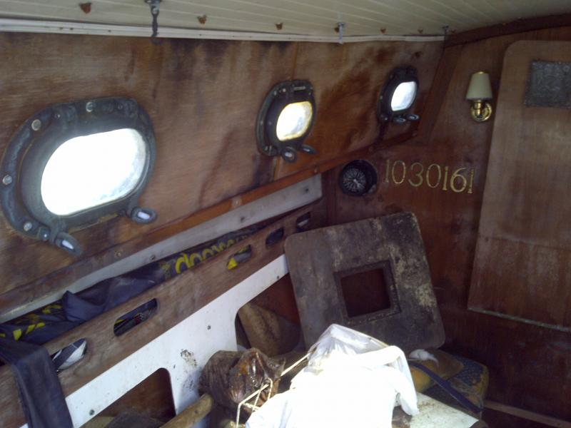

By the way, those pics that I threw in for the entertainment value is from a recent boat I looked at by invitation. A real fixer-upper.

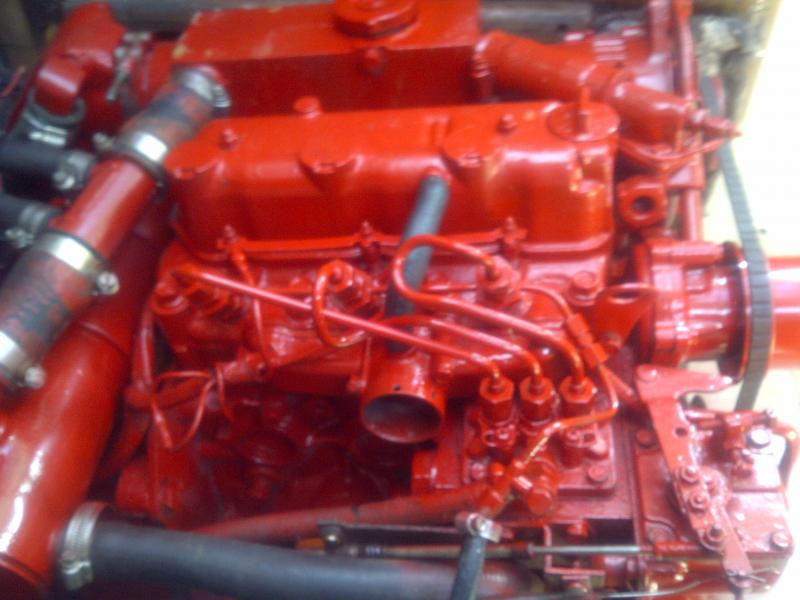

This is mine.
A clean engine is of the Lord..
