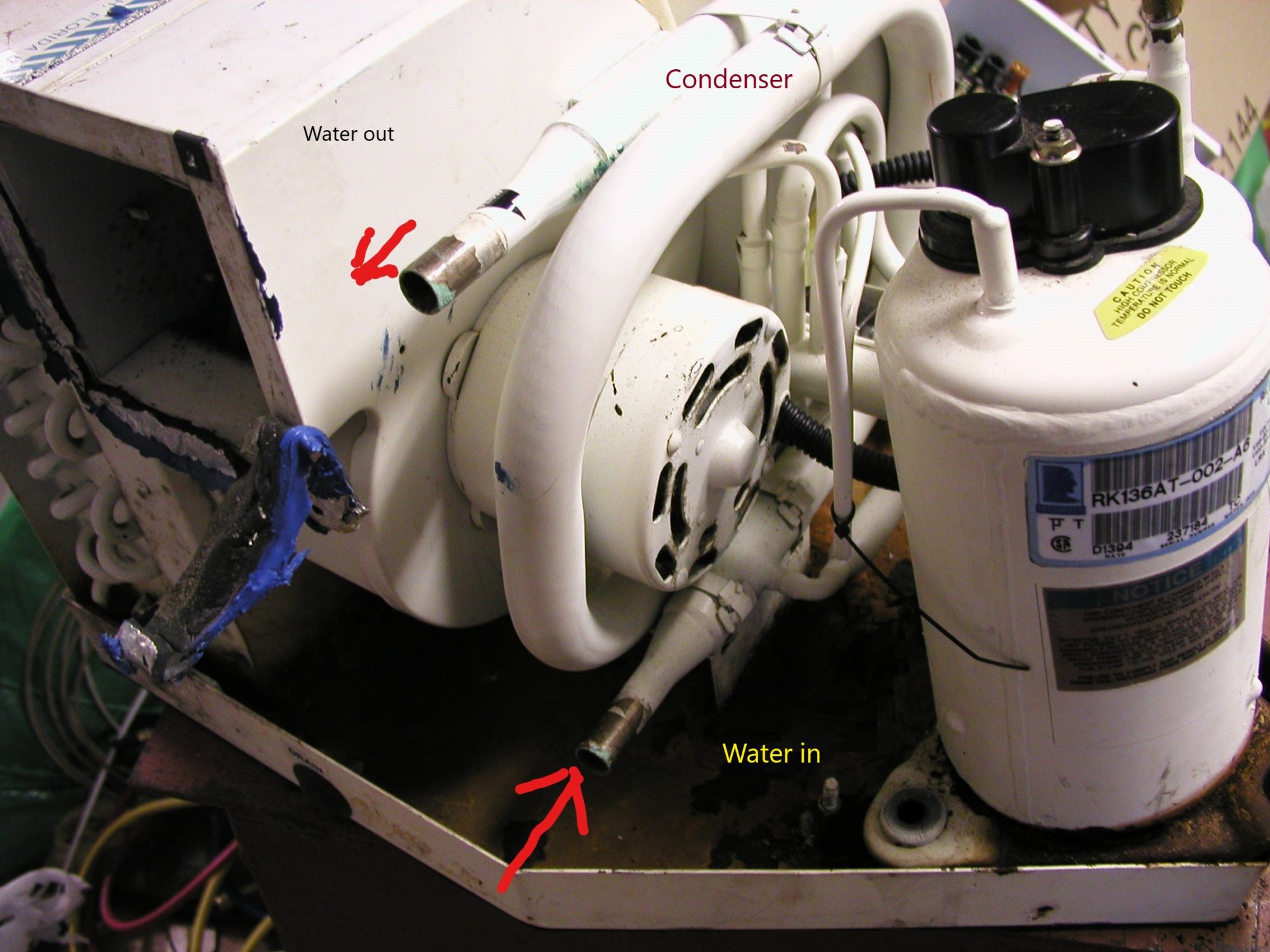

I don't know that particular system, but typically there is a safety shutdown mounted on the top of the compressor shell. The shutdown would usually be called a "Klixon" and is usually designed to re-set itself after a trip, although some do have a "push-to-reset" button. It may be malfunctioning; stuck open. It is usually inside a guard ; the attached picture shows it on top of the compressor.
This is most likely not the problem because when the thermostat calls for the unit to run, It usually turns on the water pump and fan .. then after a time delay of a few seconds, it turns on the compressor. Ya may want to check the settings to make sure that the pump is being commanded on .. If you have not, ya might try turning off the breaker at the panel and leaving it off a minute or so .. then back on to reboot the controller.. Good Luck!

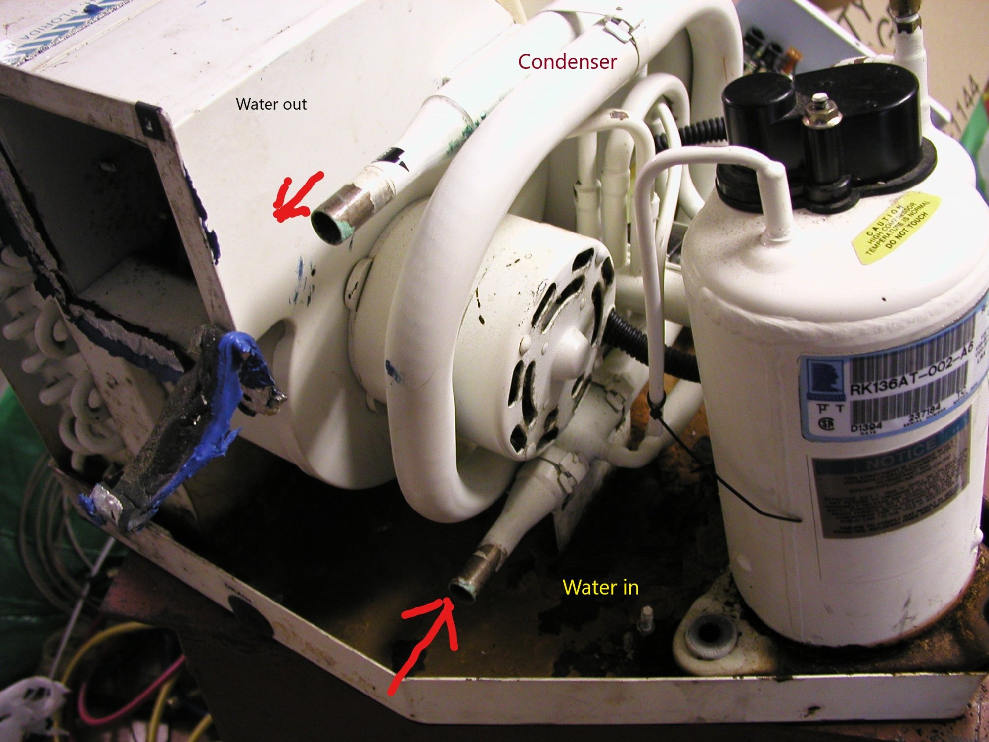

Yes, I would think I would be getting 110v at L2 as soon as I turned on the unit, but am not. Did not know if there was a breaker somewhere else, although the fan unit comes on when the unit it turned on. Thank you for the info you did provide.
