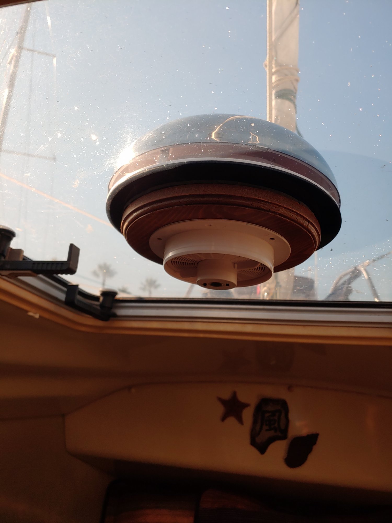

I installed a replacement in my hatch. I had two others over 22 years. I didn't have to cut it, but as others said, either a hole saw or a jig saw with a plastic cutting blade and slow cutting speed. However, the newer models are not designed for hatch installation and lack the option of a spacer. Their customer service advised me that "people don't install them in hatches (notwithstanding all the sailboats on my dock have them). They were not impressed. Anywhow, I picked up a 3/4 inch thick round wood piece at a crafts store, cut a center hole to fit, varnished it, and installed the hatch using the gaskets and screw on base. Worked like a charm and I avoided gluing the damn thing to my hatch.
