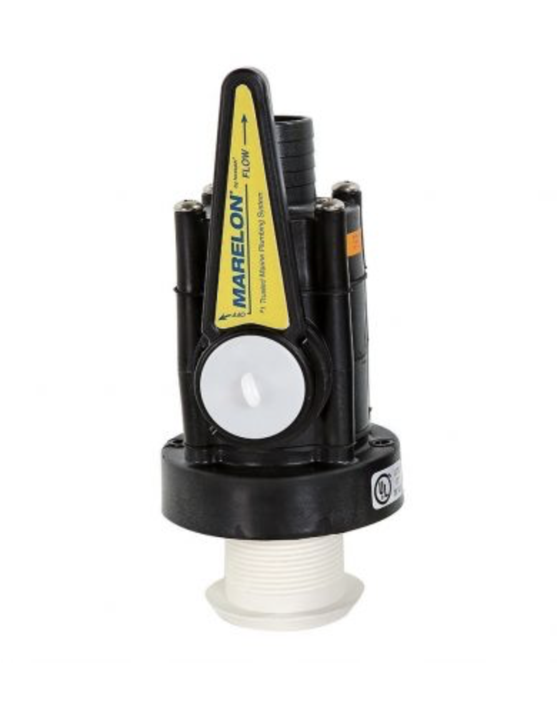

Do you have the Forespar Series 93/OEM style (picture below). If so, I have found they don't need lubrication. I do "exercise" them twice a year by opening and closing them fully 3 times. And while not necessary, when the boat is hauled for some other reason, I'll put a dab of forespar grease on the ball from outside the boat with my finger and cycle the valve a few times - can't hurt.
The other Forespar valves do need regular and careful lubrication.
The Series 93 will develop two kinds of minor (non-dangerous) leaks. The first is that the caulking around the thru-hull will fail from age and weep. The 2nd is that an o-ring in the handle will start to leak. Forespar will sell you new o-rings. In both cases, no need to think about it until you see dampness

Yes these are the Series 93 seacocks (and generally don't require any lube - just exercise). This one has developed a drip (when open). So looks like it is likely the o-ring from your description. I'll get replacements and see if that helps.
I'm assuming taking the valve apart and replacing the o-rings is straightforward? anyone know of any exploded parts diagram on these? I will be doing it when I pull the boat out of the water in a couple months (but understand that they can be done in the water if you plug the outside of the through hull.)

Parsons - if it's the original valve to the Catalina, I understand that it's likely the 93 series OEM valve. Apparently they have resisted selling that via retail because it has some different threading that they don't want folks to try to mate to other fittings. there's various info on the forespar site.
They say you can do maint on them while in the water. They each have a plug tucked into the handle that you can pull out and stick in the outside through hull (with a lanyard attached, so when finished you just pull - only one dip in the water).
I have heard of 2 failure modes, 1 (as mentioned above) minor leaking (like mine). Everyone says to replace the o-rings to fix. 2 some have broken the handle off if the valve get too stiff and is operated.
