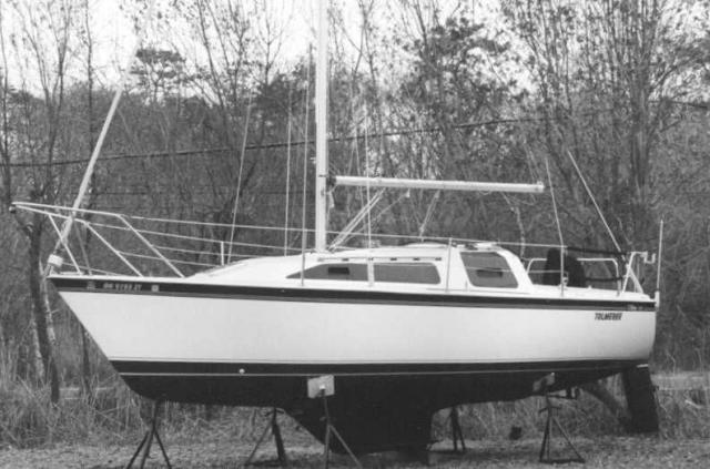

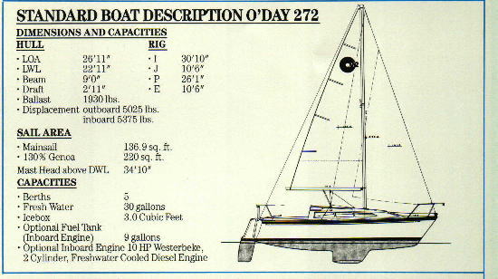

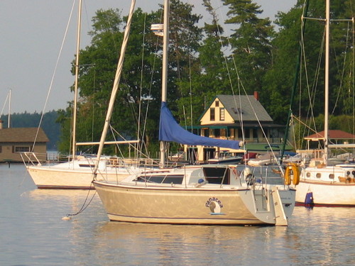

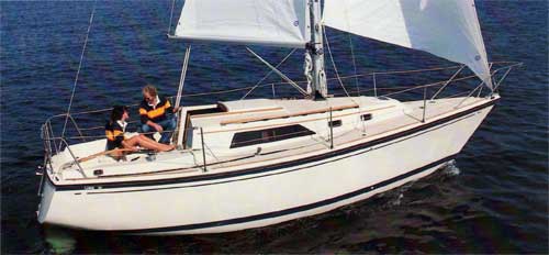

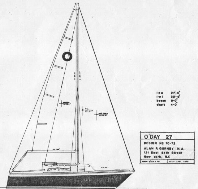

Is this a 272 or a 27?
The 272 was built from 1985-89 (model years 1986-89) and has a wing-keel and outboard rudder. If your boat is a 1988 she would be a 272. The 27 was built from 1973-78 and had a standard fin-keel and inboard rudder. The manual that you saw retyped was probably for the 27 (in fact I posted one earlier this week, no pictures from the manual)
The Preventer would not have been a factory-rigged item anyway, if the boat has one it would have been added by a previous owner and you can get info on preventers by consulting a general sailing text.
In 1988 there was also the 272 LE, which was just a 272 with several options made standard (wheel steering, Diesel inboard, etc) and a few upgrades. The 272 LE looks pretty much the same as a 272.
None of the above boats should be confused with the 280, which used the same hull as the 272 but a different deck (the 280 was the 28' O'Day that was really only 26'11" long!) or the O'DAY 28 which replaced the 27 and was built from 1979 to 1986-7.
I've attached photos below of all the models that I mention above.
