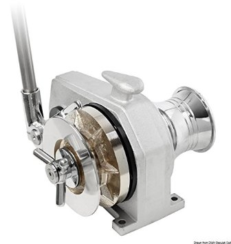

Did a quick search in a couple of chandleries and could not find a manual windlass. Checked some of the used components markets and the manual units for sale were old and probably lacking in replacement parts. To find a manual windlass you may have to look to European manufacturers. I agree that a manual windlass is much more practical than an electrical one but looking for yesterday's technology in to day's marketplace is not yielding many results. By the way I don't know how heavy is your chain but a boat your size should carry at least 30' of chain. The Photo is of an Italian made Italowinch being sold in Amazon UK by a vendor that unfortunately does not ship to the US.

Thanks Benny I ran into the same issue.
And thanks for the recommendation of more chain. I will get on that.
