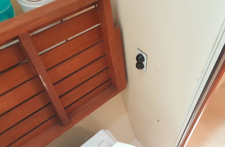

Finally found time to reply. Just FYI I am using reconditioned Raritan toilet which was decommissioned due to electronics malfunctions. Was given away in excellent condition. I have redesigned initial system to make it simple and efficient. I am using raw salt water from deck wash pump which is ON all time keeping about 2Bar pressure in "salt water" system. It connected to anchor wash outlet and transom wash outlet with mechanical ON/OFF valves and to toilet intake through solenoid valve controlled by simple push button. And I am not using vented loop. Waste motor pump controlled by another push button through external relay.
Works absolutely great and quiet. My wife and guests just love it! I probably will add later small programmable relay with timers to make it fully automatic (single flush , double flush, etc.)... May be - still like to keep it simple!
Regarding size - it fits good. I have attached few photos for refernce. I can't close the wooden cover, but we never actually closed it anyway when taking shower. I might lift up all wooden shelf it in future - I need about 40mm.
