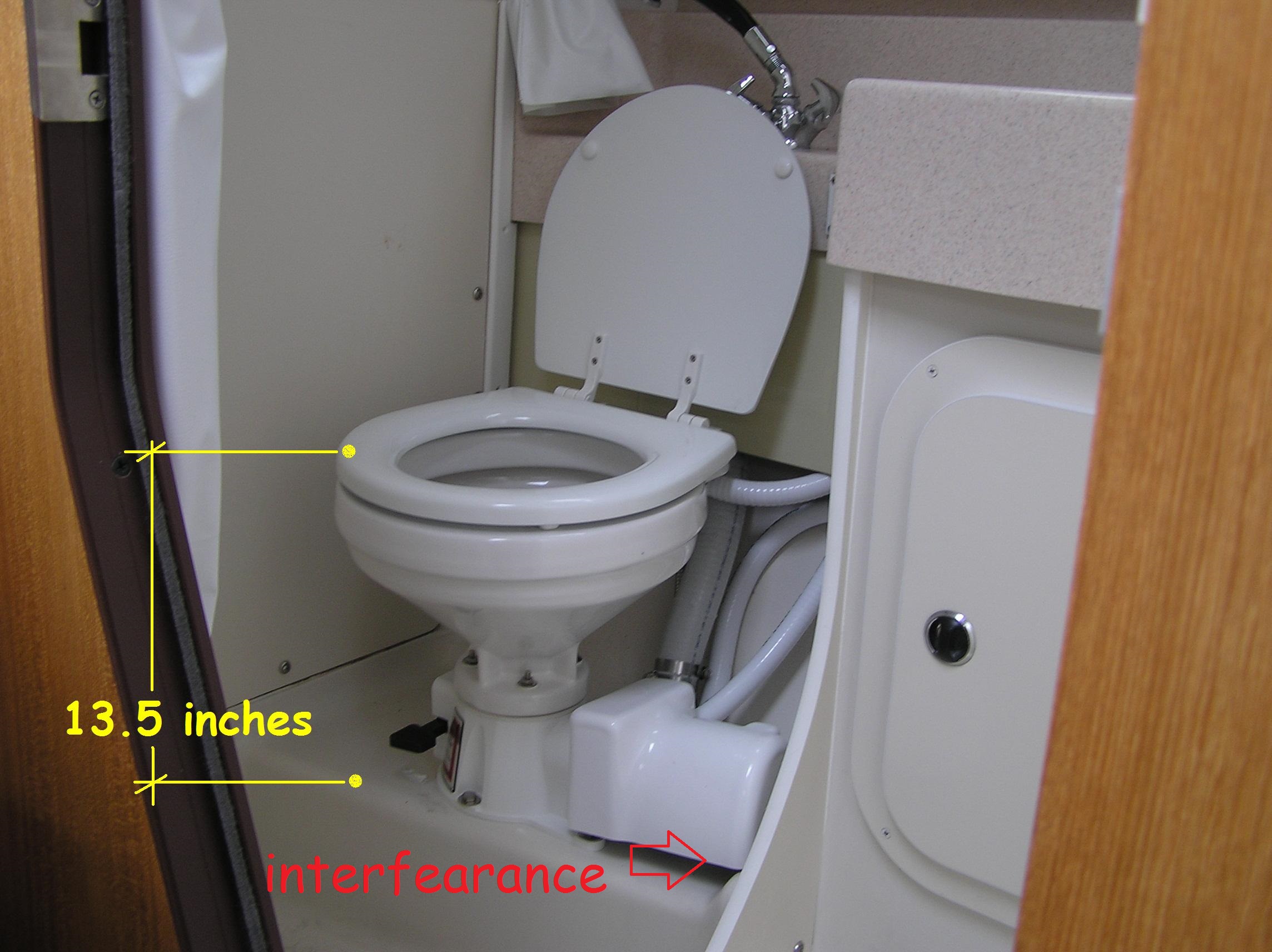

I had a old electronic Wilcox Crittenden and the motor went out......WC went out of business... no parts.
With the old WC had a problem with the motor interfering with best mounting location.
The new head solved the all the mounting options allowing a small rotation and moving around for better fit when you sit on it and showering.
The new head will also allow you to use a smaller hose running to the waste tank....I did not do this because I had already installed a new hose, but this is a big is a positive for hose replacement options.
Best upgrade ever.....easy to install....best customer service.
