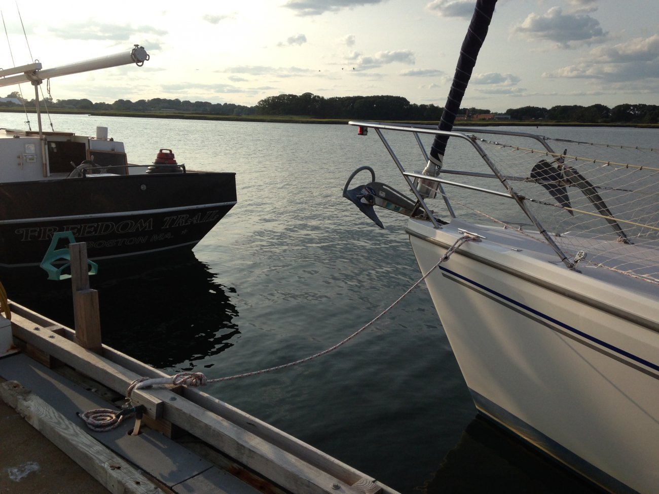

Just in case any 310 owners are wondering, the Mantus anchor fits fine on the 310 bow roller. I wasn't sure it would.
bob
That is a nice fit! But you need to secure it better than that. Snug it back against the bow roller with a stout snub. Either a cleat in the locker from the shackle, or a link to the hole in the retrieval hole in the shank.

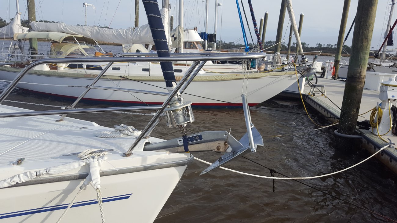

I spent all afternoon on securing it and actually have it secured 4 different ways but intentionally it does not look like it. The anchor is top heavy in the roller and wants to tip forward. Have the roll bar tied off as seen in the picture. Also have the shank secured with a strap to keep it down. Then have the chain secured on the drum and cleat and also have a line from the anchor shank tied off on the windlass drum.
Likes: Tom J
D
Deleted member 117556
Ha! I didn't notice the line from the roll bar to the pulpit until you pointed it out. Keep your boat knife handy. You might need to deploy that anchor quickly some day.
Yes, now I have too much security! Roll bar is connected with a stainless carabiner so easy to release...

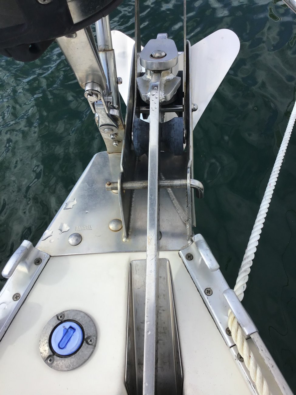

Save some hardware. Get a Johnson cleat on your pulpit and loop it through the anchor roll bar. Done.
Stu...can you be more specific because this may be what I was looking for. Googled Johnson cleat and am not sure what and where you mean?
23,497
I'll find a picture, give me til tomorrow?
PS How about now?
The cleat is on the inside of the horizontal lower SS.

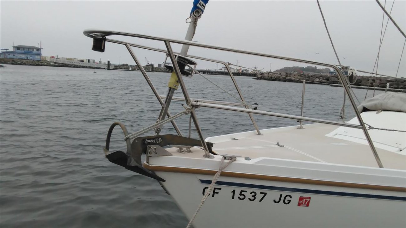

I say, either stow it when underway or put a pin, or retractable bolt (see above), through the shank and mount that can be quickly pulled for rapid deployment. Might have to build a U-shaped “shroud” over top of mount or build up the sides some, from the appearance.

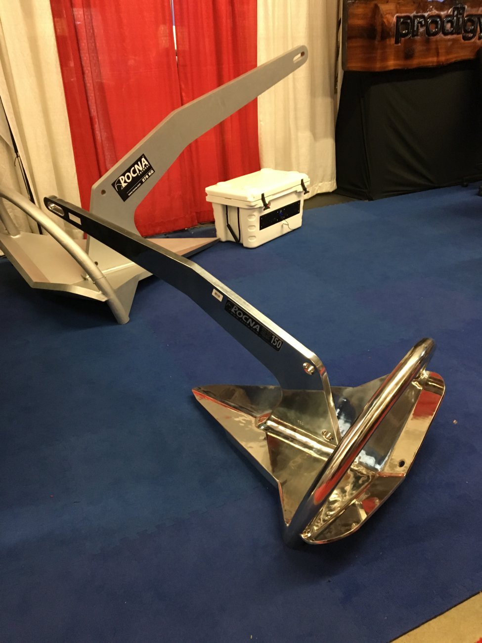

We were just at the Vancouver Boat Show. They had a couple of anchors on display. Salesman suggested these as anchors guaranteed to keep a 30 ft boat in place in the Gulf Islands off Vancouver Island.
For perspective I stand 5ft 10. And theshanks of these stood above my waist.
Pretty sure there would be a fitting issue and loading them on a boat would affect the balance. But on the plus side once deployed the boat would need to chafe through the line before it got away. Guaranteed not to drag.
