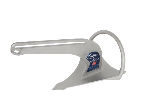

Hey all, so I'm out of town and I found a Manson Supreme 45 on craigslist for $300. Shouldn't be a problem fitting on the bow roller of the Hunter 38 do you think ? Obviously I'm not anywhere near the boat but looking at the bast photo's I can find I don't see any reason why it wouldn't fit.
The reviews I've read are pretty positive. Any experience ? Gotta be better than the little Delta it came with

Good price and its lists for $451 plus sales tax and shipping!! Should fit fine. I had a 35 pound Manson Supreme anchor on my 2004 Hunter 386 and the 45 pound is only slightly larger (see dimensions in the attached file). I like its long straight shank with separate attachment points for the rode swivel and a tie-off rope from the shank to the cleat in the anchor locker. It offered excellent holding power in the SF Bay mud.

Bob, thank you for the tip. I had read that they had some clogging issues in grass. Can I ask what you are using ?

Yes, I think Panope's tests showed some problems with resetting consistently due to buildup on the fluke. I went with a 55 lb. Mantus and an all-chain rode on my 410. I spent more than one windy night in the Bahamas last winter watching boats all around dragging while my Mantus held tight, and would buy one again in a heartbeat. They occasionally go on sale and you can get a good deal then if interested.

I used a 35-pound Manson on my 34' catamaran around the Chesapeake (where you are) for years with zero problems. It also sounds like the right size for the boat and the area. And yes, it is much better than Delta in this area (it replaced a Delta).
I've done a lot of anchor testing for mags, most of it in the Chesapeake area. You can debate "which anchor" forever; there is so much scatter in the data that differences are seldom statistically significant. The big differences between modern anchors related to yawing and the bottom, not the anchor choice.

Well, consensus seams to be that no anchor is perfect and that if the Manson has a weak spot its in weeds. And that the Manson will be a big upgrade over what I have now. I think if I can get it for half the price of a new one I'd be doing pretty well. I'll just have to watch the weedy bottoms.
