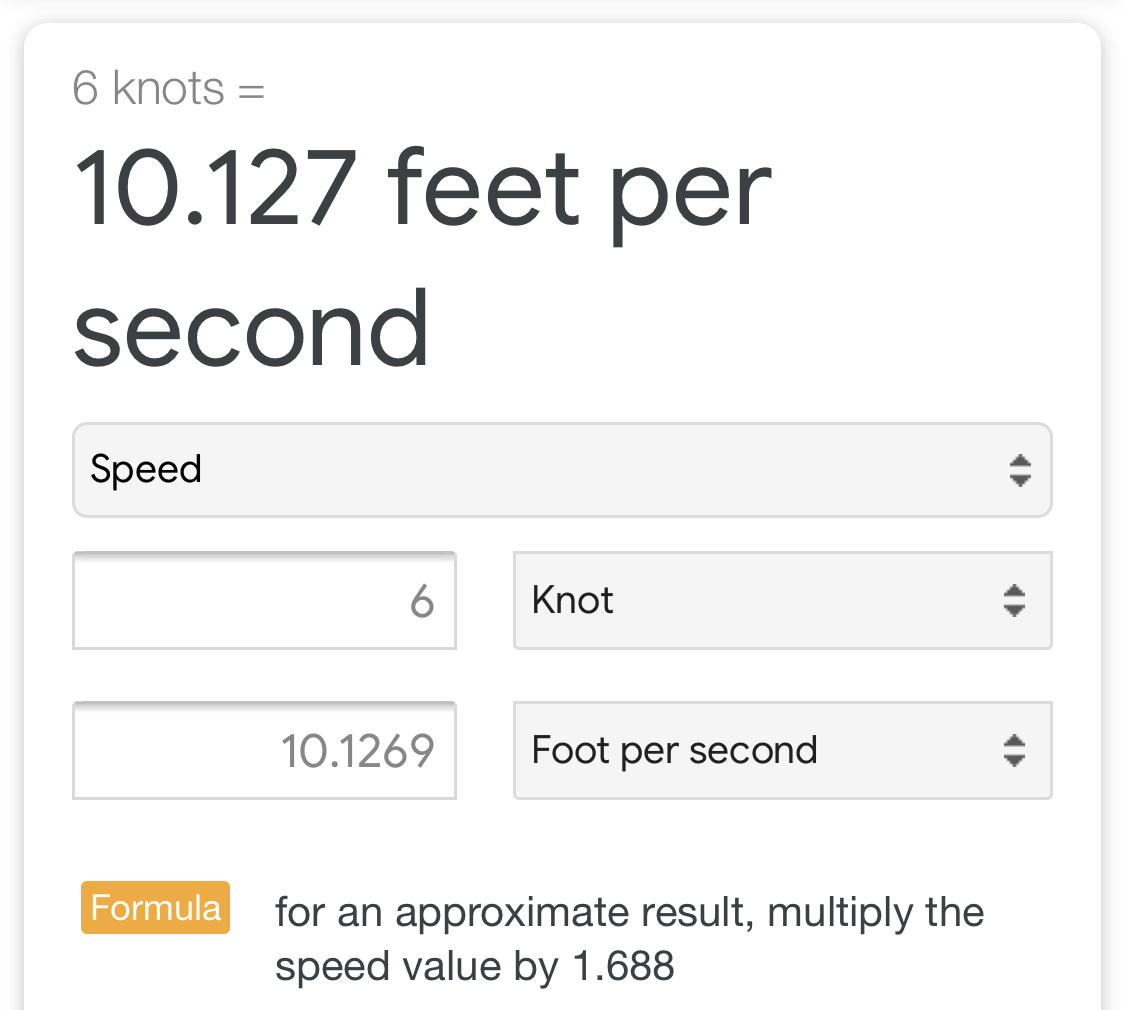

Assuming the boat is doing round 6 knots, i f they don't get knocked unconscious by the boat hitting them, I'd put your best bet at putting the boat into neutral and throttle down after. Either way, I doubt they'd come out unscathed.

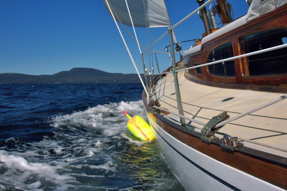

We have this drill all the time. But the MOB is a buoy. The call from the bow is POT!!! That tells the helm we've just run over a buoy. If under power, jump for the shifter, and throw it into neutral. That seems to work if, or I'm fast with the shifter. There is only a second - maybe two, at best, doing hull speed.
I don't want to imagine the scenario but it would be difficult for a MOB to find the prop in the keel/rudder aperture, if you fell off the bow, but the result is too grizzly to imagine.
Under sail, we just forgetaboutit.
I've run over hundreds of them. They go 'boom, boom, booom' along the hull,...then 'pop' at the stern. Then usually one more 'BONG' as they hit the bow of our dinghy.

Seeing @TomY ’s great image of a buoy bouncing along the hull reinforces the importance of crew wearing a PDF. If your floating on the surface you are less likely to visit with a sailboat prop.
