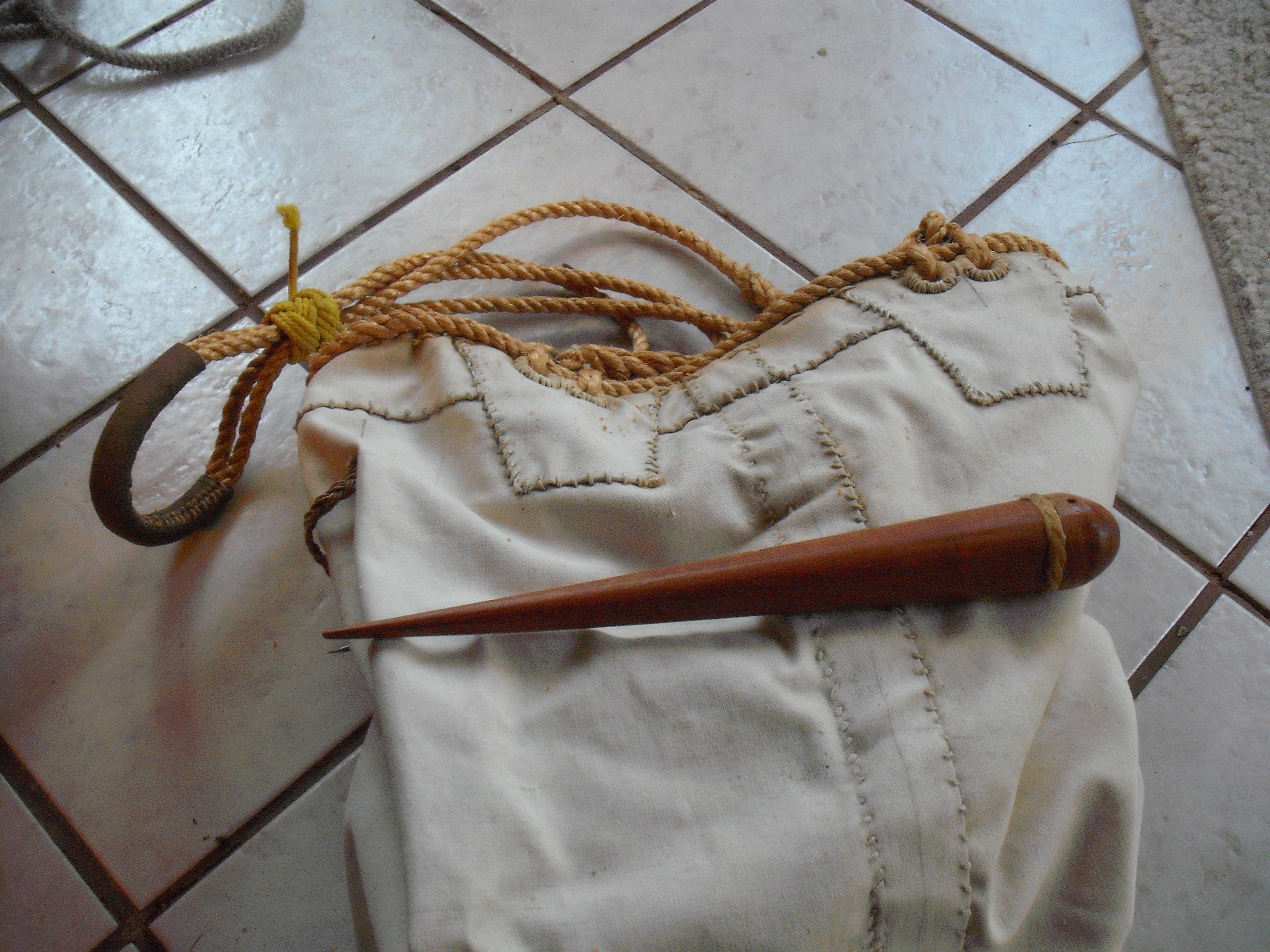

I dito purchasing the "Sailmaker's apprentice", a great book that will allow you to become a pro in short order. Make the ditty bag!!!
there is nothing like looking up at "your" sail and hearing the water rushing around your boat. If for no other reason than that I'd recommend you design and make your own sail.
A word of advice, you will be spending a lot of time with the "finish" work as you don't have a press that can quickly install your cringles and other stuff. You will be hand sewing all the "holes" as a sewing machine will not do that kind of stuff.
