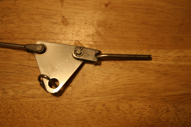

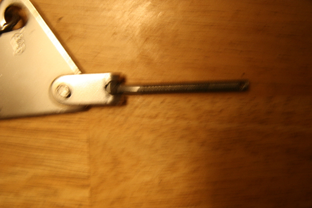

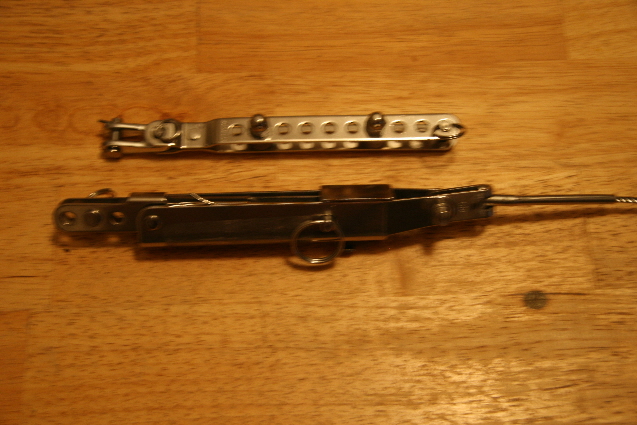

Finally got some pics, sorry it took so long. The handy lever will only work at the bottom of the backstay. It would work better if I shortened the bottom end however. It has three pin holes, and if I cut off the two end ones and smoothed it, it would leave more adjustability in the turnbuckle.

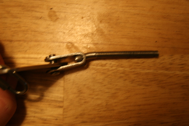

The lower turnbuckle T-stud looks bent, as seen in the pics. I know some of these have a curve in them at the T for some reason I dont fully understand, if thats normal then I will accept it. But it also has a bend perpendicularly to that curve. Sorry the pick is fuzzy, but you can clearly see it is not straight, and I think it should be replaced. Do I use a straight one, or a curved one?

Its not the turnbuckle thats bent, its the "T" stud. I believe it was originally curved, but it is also bent perpendicularly and I cant believe it came that way.
10,202
I don't think the T stud is supposed to be bent, but you do see a lot of them that are. It normally happens when the mast is going up and the T-shackle-pin get jammed and can't swivel. I bent three in one day on my old trailer sailor..Much easier to do than you'd imagine. Replace it, they are pretty cheap and readily available .. some are left threads and some right.. I always carried a couple of spares when I had that boat.
EDIT: That one is not too bad to use as a spare, but do check the threads in the bent area for cracking before keeping it.
