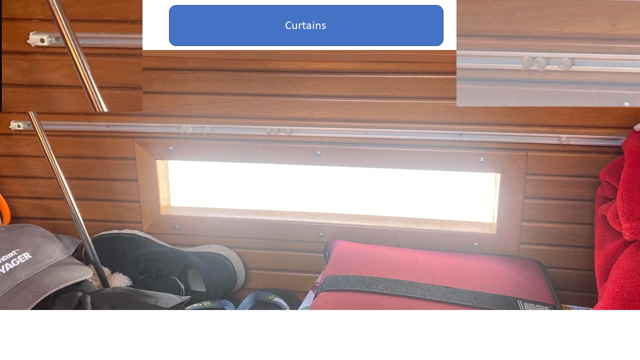

Hi All,
My 1975 Dufour 34 has a track for curtains.
I think it was the original track but no curtains as previous owner re-did the cushions and probably threw out the curtains as they did not match.
He reupholstered to solid red and the boat originally had that 70s plaid thing.
Any suggestions as to how to go about and make curtains ?
I am guessing
Split the curtain in half.
use curtain tape to be able to add hooks
add hooks in the back as they would fit in the plastic holders on the track.
Since there is no track at the bottom.
Do I weight the curtain bottom by doubling fabric ?
Any fabric you found nice to work with ?
Thickness?
Thanks

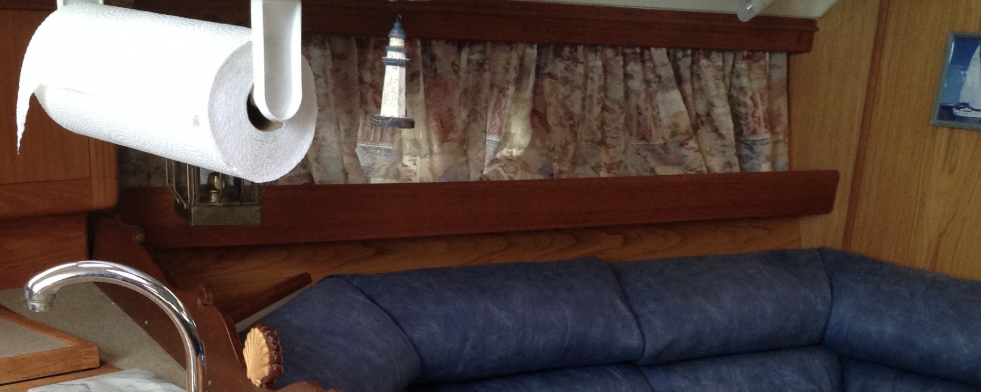

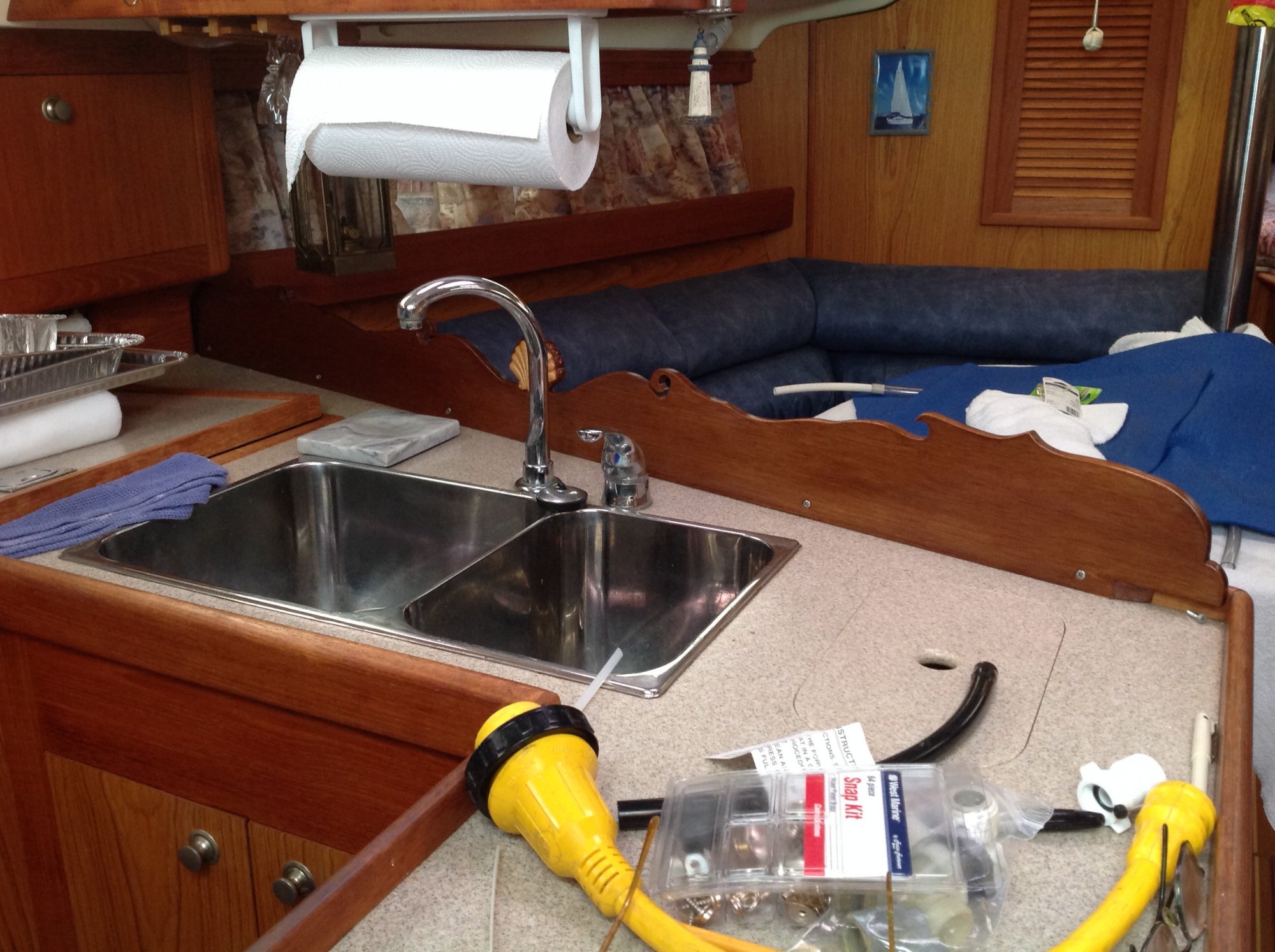

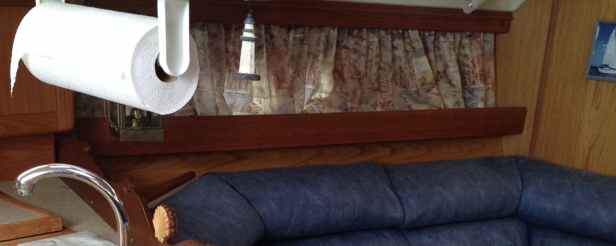

Our 340 has curtains as well. They do provide privacy and a sense of warmth up on the cooler days. Ours are hung on rods, as normal curtains would be, weighted in the bottom corners of each one, but not a lot of weigh. As they really don’t blow in the wind.
Unlike yours, ours run in the shelf under the window. They do collect some pollen and dust but a quick vacuuming up takes care of that each spring.
I think you will enjoy having them on your boat.
This is the best pictures I have at the moment for you to look at. The same on the other side of the boat as well.

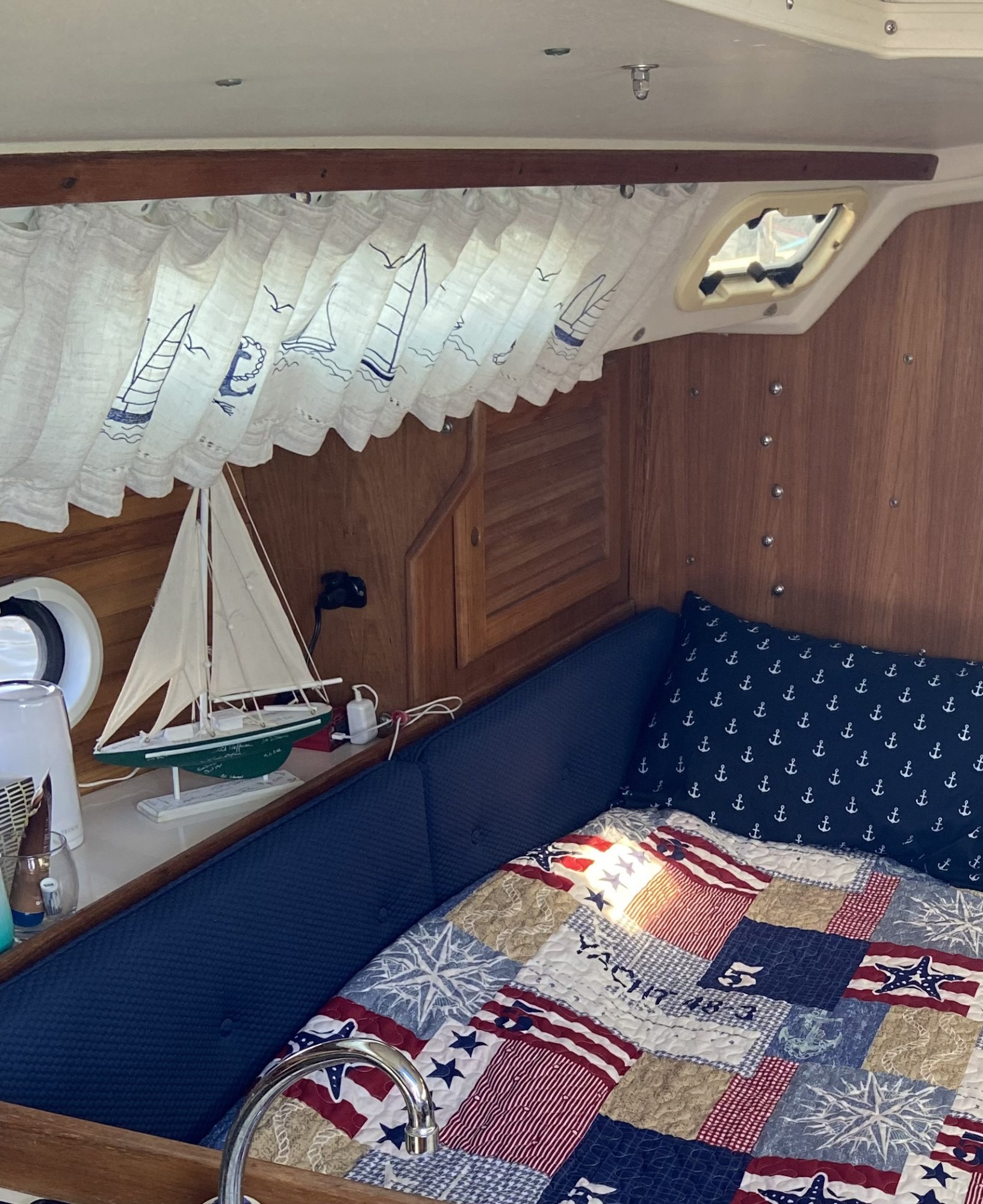

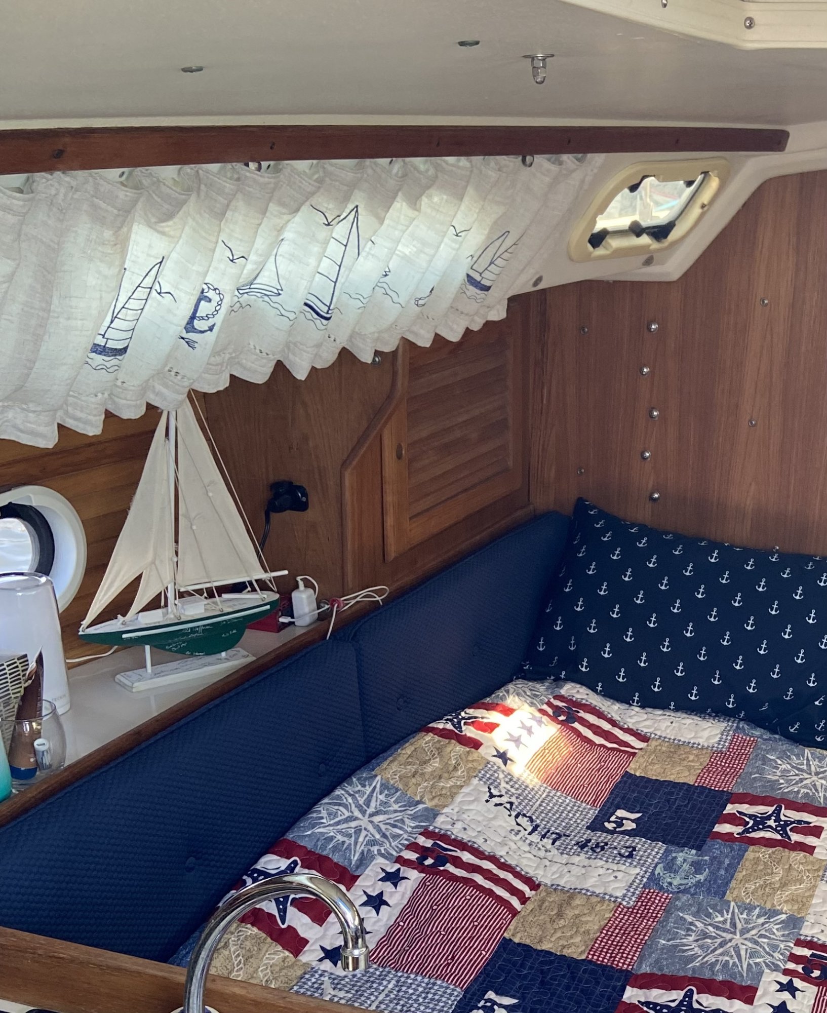

My boat had some Recmar curtain tracks in place when I got it. I purchased what I needed from Defender to complete the curtains tracks, the track slides and webbing with snaps on it that snapped onto the track slides.
Then went on Amazon and bought curtain valances I liked and sewed the webbing straps onto both the top and bottom. This holds the curtains snug to the window area. I made them longer than needed so they would have a pleat and I split them in half for each window.
View attachment 216655s
learned a new word today. "Valances". ;)
Nice maritime theme going there.
